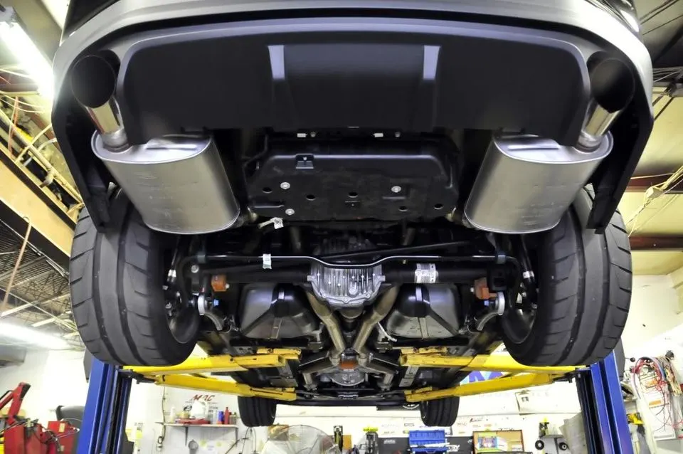

The picture that it shows is awfully small and it is hard to tell if it is the GT 500 valance.

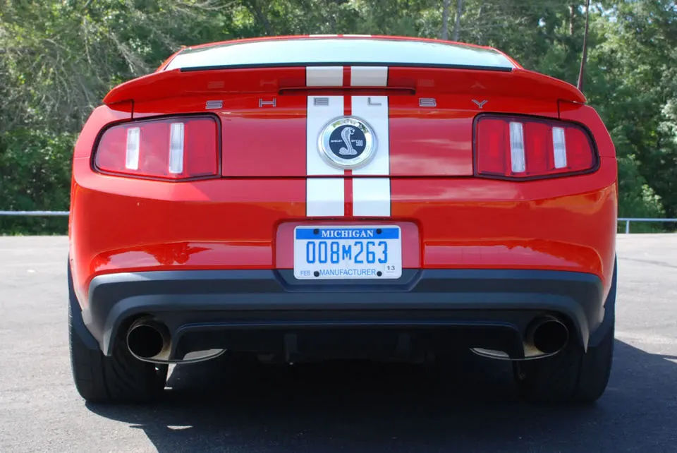

I sort-of liked the Roush rear valance, but after seeing it in person, its is very "boxy." After seeing the GT500 valance, I fell in love. The car is, however, being adorned with the rest of the Roush body package :)
you can only order the rear diffuser (which is different from a gt500 diffuser) if you pay to have the dealer install it for you. It wont let you order it for yourself.

I just installed my GT/CS rear fascia (same as GT500 ?) tuesday.
I saw it advertised on ebay as a OEM GT replacement valance. But from the photo, I knew what it was.
I got it for $80 !!
It was a little bit of a pain to install (SOLO) with no instructions & no lift. I did not remove the rear bumper completely but did have it pulled lose on both sides. I lost alot of skin I didnt even notice till I was finished!
I found a 1/4 drive ratchet, 1/4 socket w/phillips bit incerted to be very usefull for not removing tires, also for screws inside the panel.
I love the look, with my Boss front and splitter. Looks great!
