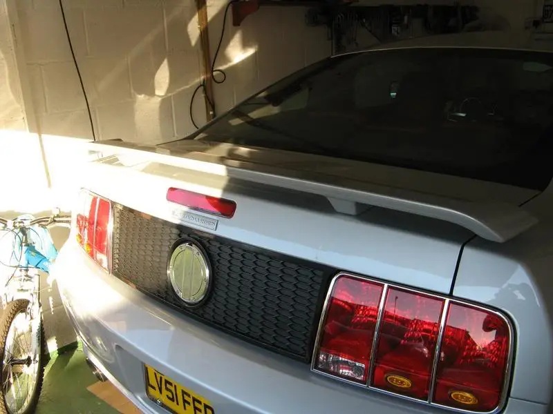

Well I got my spoiler and fitted it last night. According to the box, this spoiler is made in Malaysia. I think the only disappointment is that the front of the spoiler can't be bolted down and the end pieces of tape wouldn't stick down to the trunk lid at the forward 50% of it's length although the tape running across the car sticks just fine.
The tape can be pressed down but it takes quite a lot of pressure and I'm confident the tape simply couldn't hold the spoiler down flush and can't stick a heavy enough weight on the spoiler to attempt to get it to stick.
Obviously this means that water can get under the spoiler at the ends and I considered removing it and using fresh tape to try and get it to lie flat but after looking at the spoiler for a while, I couldn't see any way of altering it's position enough to change the way that edge is always going to lift and I don't think they make tape strong enough to force the moulding to lie as flat as I would like. I don't really want to use silicon to seal the ends so may have to take it offf again (if that's possible...) and retape and possibly put a thicker piece on that forward edge.
The spoiler was simple to fit using two of the original bolts though and the color match is good. Will put up pics when I'm happy that I can't do better. LOL.
My tape doesn't touch on the ends, either, and I was a little scared at first. But more than a month later, it hasn't come unstuck where it does touch, and noone has noticed. I forgot all about it until you said something.

Yep, these things seem so major at the time you do the fitting. Annoyingly, I had another look tonight and removed the spolier posts forgetting I'd reused the white plastic discs the post screws into. Obviously, as soon as I removed one of the posts that disc went for a swim in the void between the spolier and bootlid. I considered removing the spoiler to do it again but had to face the fact that once these things are stuck on, they're not coming off. If it was that hard to get off the two patches under the pedestal, removing this doesn't even bear thinking about.
So now I'm going to forget the bit no-one can see and enjoy the result!
After nearly a week the ends of mine are still "stuck".

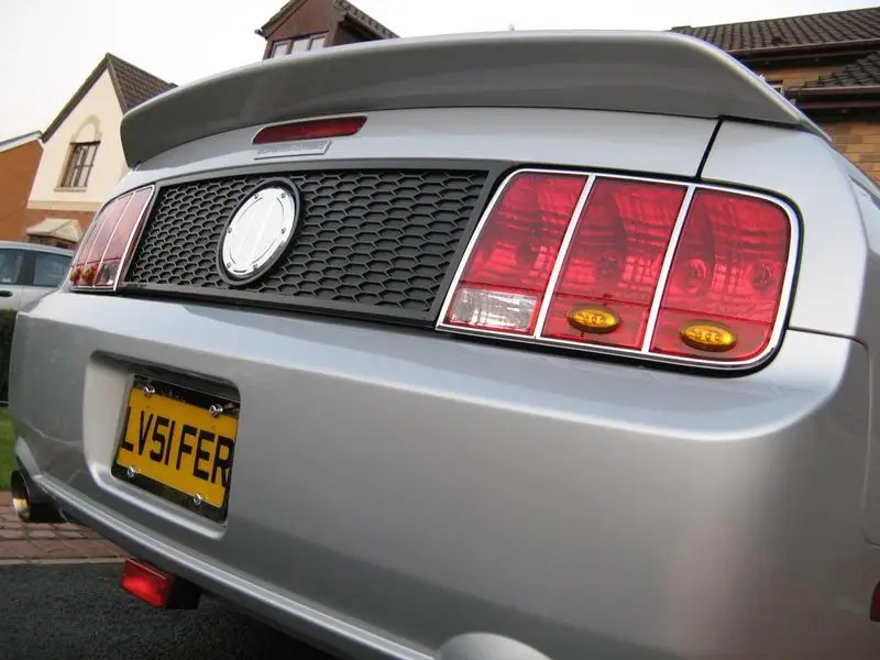

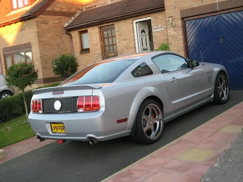

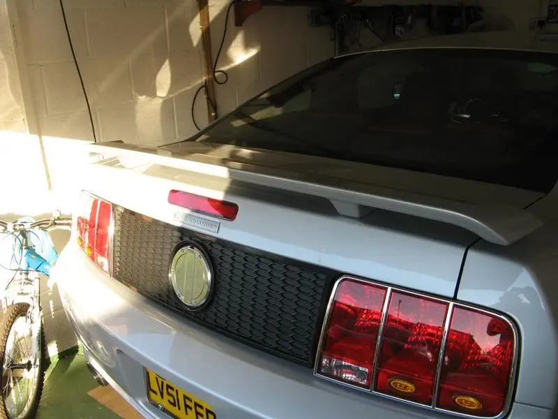

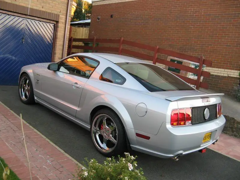

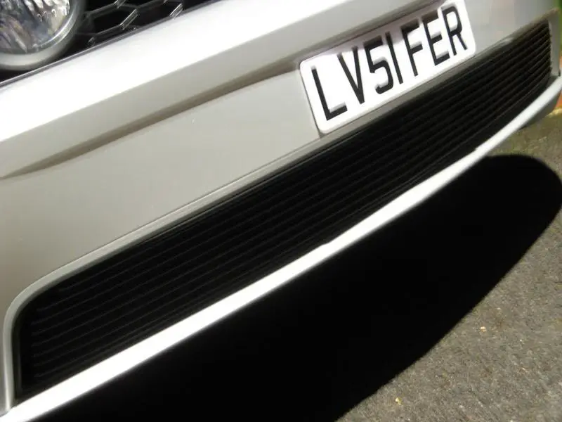

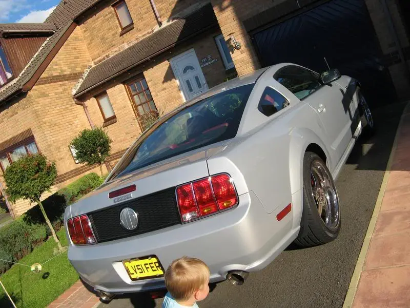

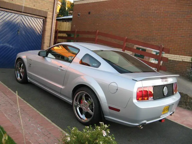

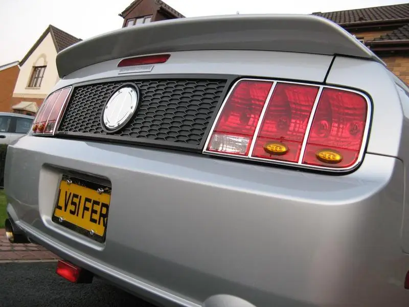

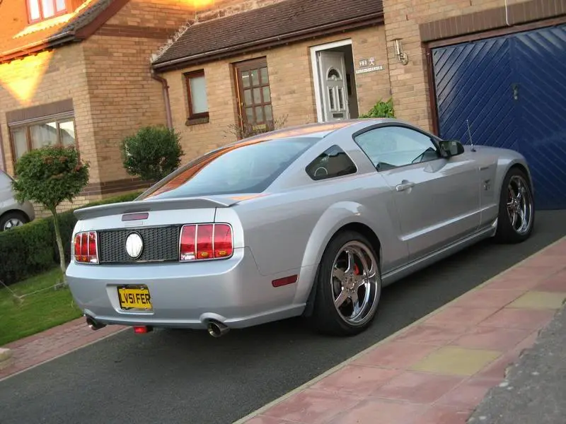

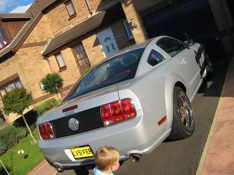

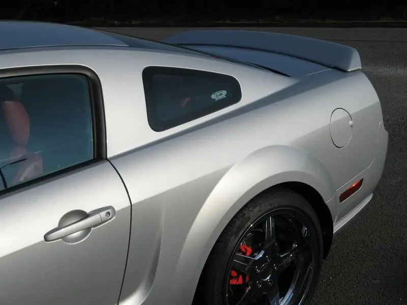

Pics of old spoiler, no spoiler and GT500 spoiler plus some late night pics of the Foryar lower grille insert:
