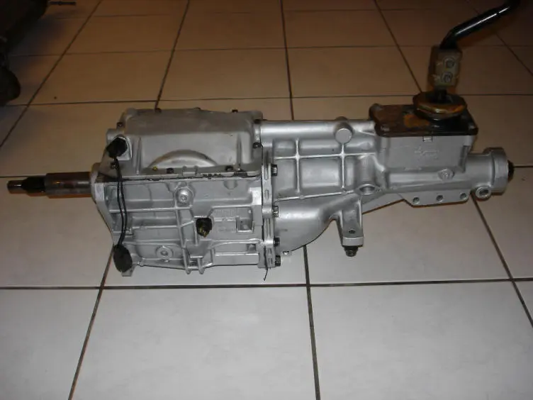

Nothing is nicer than rebuilding a clean T-5. I did this one in my living room because i got it spotless

dayum clean tranny. Too bad they cant stay that way. Are there any problems with taking the rear housing off and then pressure washing it with the main shaft still in it (minus all the little parts that might come off). that way everything is held in while spray it. otherwise I just plan on laying everything in the drive way and dousing them with degreaser and spraying them off.

Everything inside is pretty much clean anyway. Just clean the trans externally first and then open it up. As you disassemble everything, just wipe the parts off with a rag. No real reason to degrease everything.

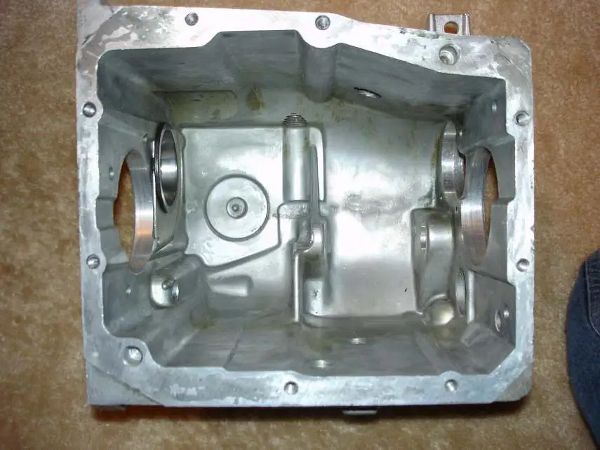

Then when i got it down to bare casing, i took everything to the car wash and powerwashed the case, top cover and tailhousing and then painted them with aluminum paint and began my reassembly.

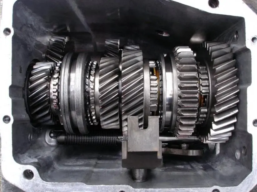

The exterior is what gets filthy. Inside of the trans is relatively clean. This is what one looked like when i opened it up for the first time. Drain the fluid and not much to clean up really.
Of course, this is an original 30K mile T-5 i have squirreled away :) But some of the 100K mile T-5's i've done have looked just as good
