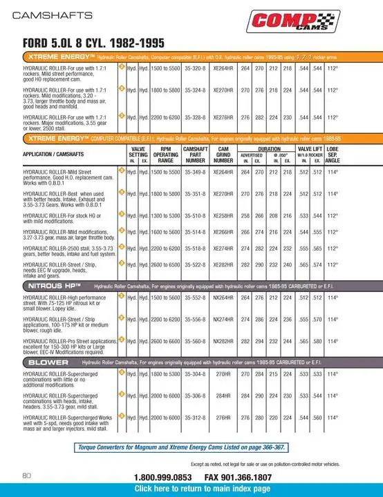

I've got a Comp Cams XE284H on the way...CC's Xtreme Energy blower cam line is very good and there should be one to fit your application.
