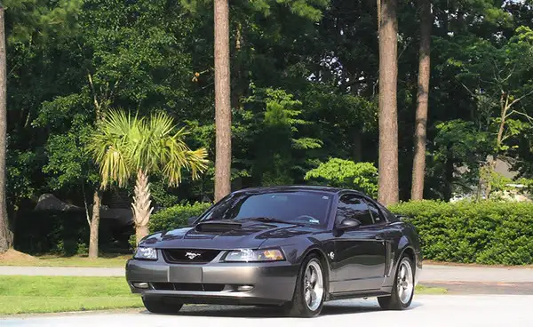

i just want to whore a picture around of my supersports setup..i also used tokico illuminas(5 way adjustables), mm caster/camber plates, steeda bumpsteer kit, and steeda x2 balljoints
