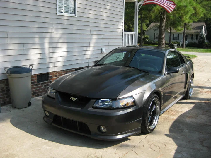

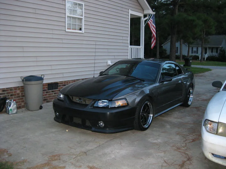

Over the weekend I installed my Maximum Motorsport CC kit and my H&R Super Sport springs. Took a few pics. It looks so much better in person. Ride is a little harsher but the control and feel, especially around curves, is amazing.

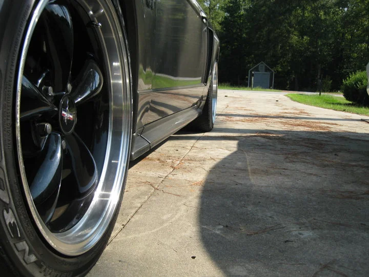

2 more..

I had those exact rims and springs on my black GT back in the day...the stance is killer. They'll settle a bit as well in the next few weeks in the front and itll look even better.
I wish they made the Super Sports for IRS cars

Yeah, she sits so nice now.. I was really happy with it. I can't wait to get all the body pieces on and get it all painted. I always get happy when I add a new piece to the puzzle...

Looks killer... you got a strait on side shot of before and after.....
did you do anything else to for alingnment/tracking

looks awesome man...nice stance

looks great man. what size tires are you running on the front and rear? did you reuse the factory isolators or replace them ?

I added the Maximum Motorsports Caster / Camber kit to aid in the alignment and I replaced the struts with new ones.
I'll look for a full on side shot of it before. I'm sure I have one. I'll post up some comparison photos when I find them.
I'm running 255/35/18 fronts and 275/35/18 rears. I want wider rears but couldn't pass up the price of the tires. I paid less than $100.00 each. Later on I'll probably go with a much wider tire. I reused my factory isolators. They were in good condition.

Love the stance!

amazing looking car , and the stance is pure evil , well done sir
