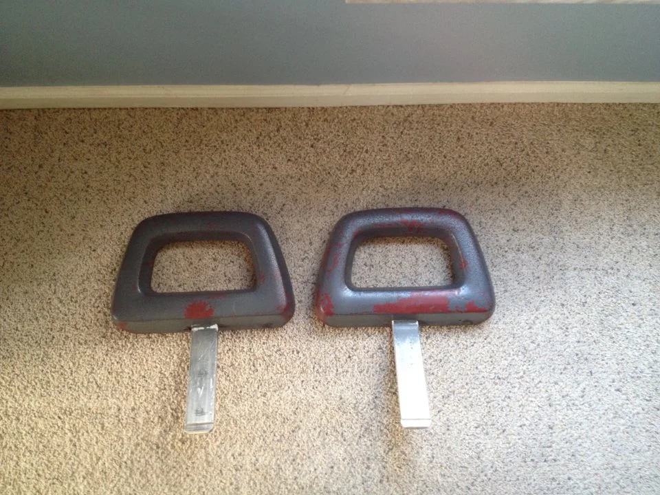

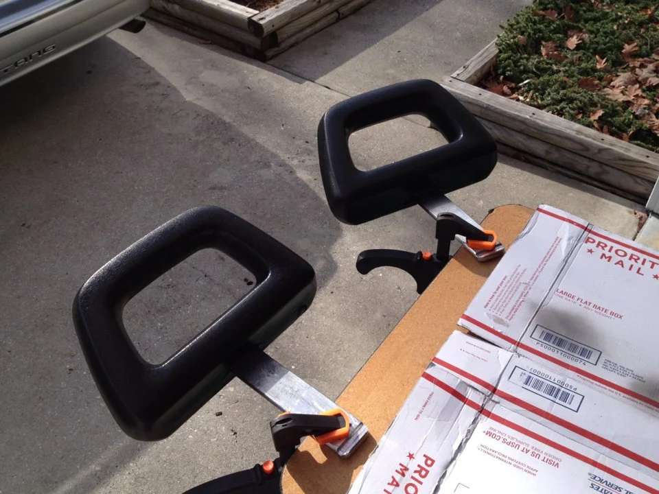

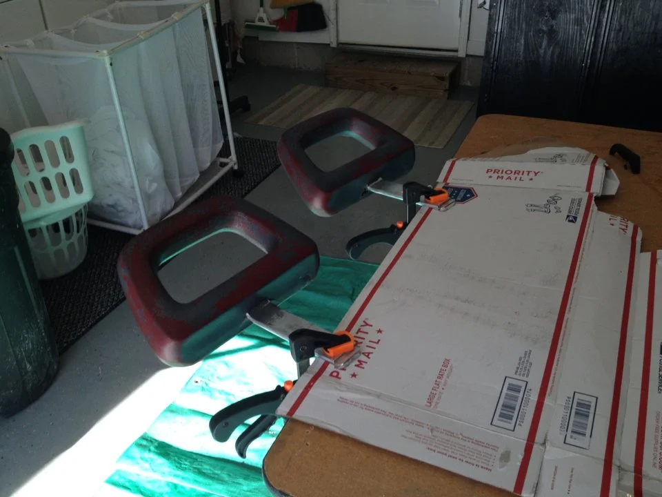

Well I was able to get a great deal on a set of halos. I bought a pair for $50. They were originally porno red and were spray dyed gray. I'm going to clean them up and paint them black. I have a can of black SEM paint I bought from LMR when I refreshed my interior. What's the easiest way to release the stock headrests to get them out?

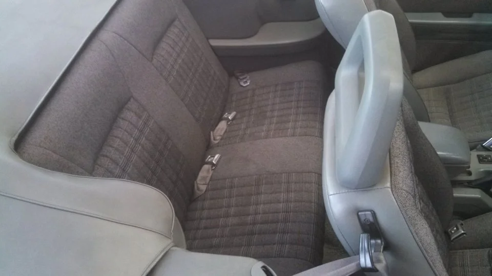

Can you pull the headrest up on your '91 seats and snap a pic? I can prob tell you then dependingon how they attach to the seat
I'm at the office right now "working" :)
I can tell you if that helps. There is a metal mounting plate on the tops of the seat frames under the upholstery that has 2 mounting holes tapped in it. The guide brackets have 2 matching holes that you mount them to the top of the seats with. I can take them off easy enough by removing the 2 screws. The holes would most likely be covered and hidden by the halos. I would just not have the guides to hold the belts up for easy access.

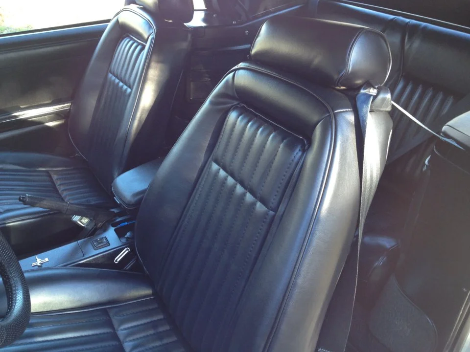

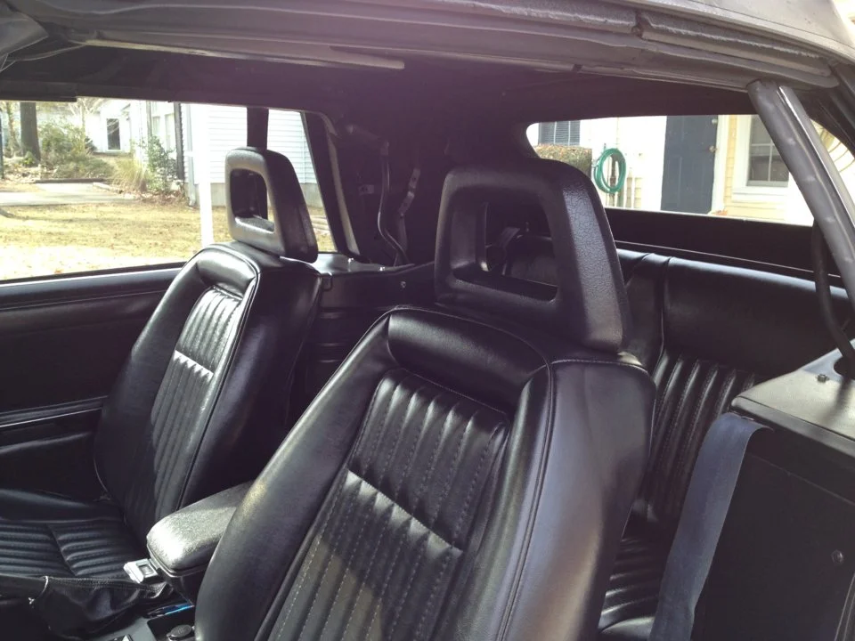

Well, I got my halos installed this morning. I think they turned out pretty sweet. I was able to just pull up really hard on the old ones and they popped right out. I did have to remove the seat belt guides from the tops of the seats though. They were right in the way. Thanks for everyone's advice and input.
