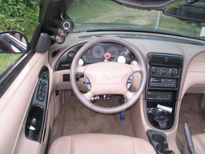

B&M hammer w/ hurst handle:
attachment.php
triggz said:
The stock shifter is simply attached to a cable that slides in/out as you push the shifter forward/back... A ratchet shifter can be pushed downward as it pulls the cable, and it will then release the cable and spring back to its original center position, however the cable will be moved.. Repeat forward/back to slide the cable in increments(ratchets)..
Hope that makes sence.
Many shifters have gate mode AND ratchet mode. Gate mode is the stock-style operation of sliding straight through gears.
Thanks! That looks pretty cool. Did the shifter you bought with yours come with a big plastic base? I assume you just don't use that, because yours looks good in the stock casing. I bought one, but didn't think it would work, and returned it. Maybe it would have worked after all.

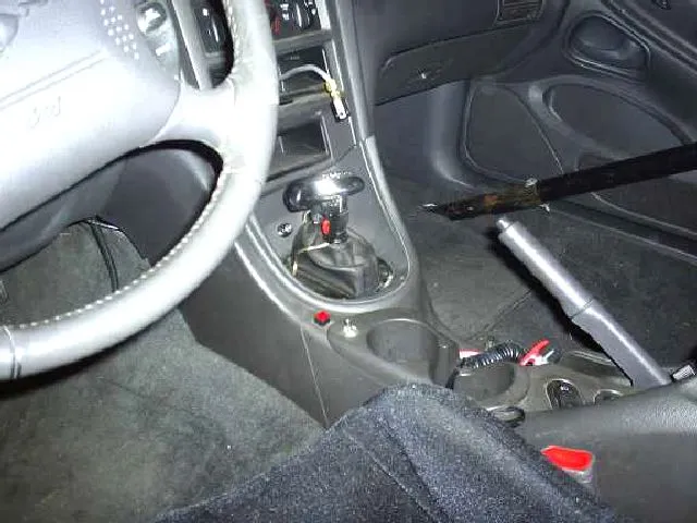

I have a B&M Hammer shifter. I also have a PA fully manual transbrake valve body. With this valve body, I have to shift manually from 1st to 2nd to 3rd to OD. The tranny will no longer shift automatically. I got the Hammer shifter to prevent accidently shifting from 1st to 3rd at the track. It works great with the manual valve body. I'm not sure I would want it with a stock valve body. It would really serve no useful purpose.
