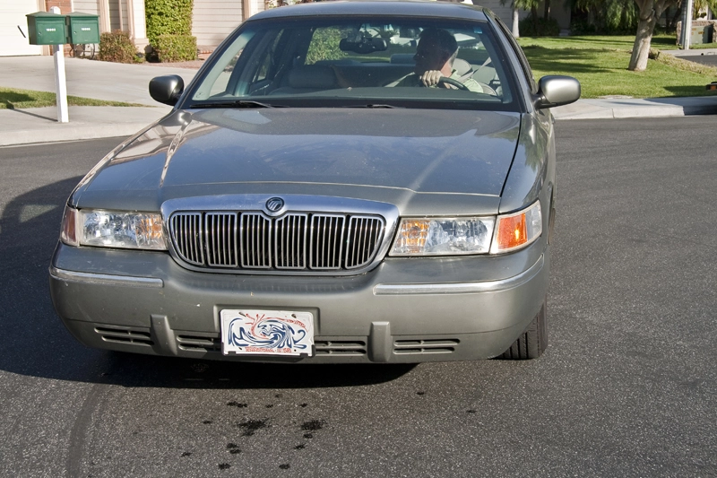

The Owner (My Dad) DD's this Grand Marquis. Because of his job, he drives ALOT. The Car currently has 225,XXX Miles on the clock lol
My dad never lets be detail the car because it gets beat in Los Angeles on a daily Basis..... But he was having problems seeing at night because the headlights were all clouded over. He was driving from LA to San Fran. this weekend so he hired me on to fix his lights.

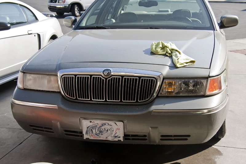

3M Sand Paper
800 Grit
1000 Grit
1500 Grit
2000 Grit
CG Scratch & Swirl B-Gone w/ 4 inch Orange Hexlogic Pad
CC Pro Polish+ w/ 4 inch White Hexlogic Pad

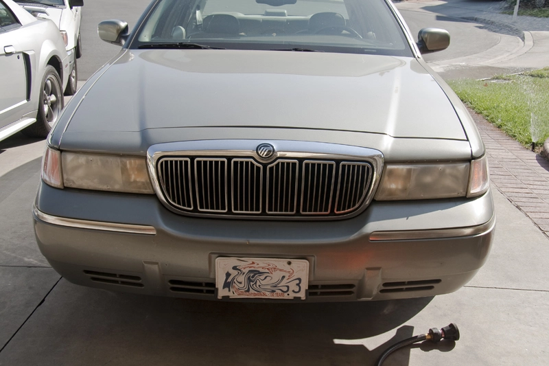

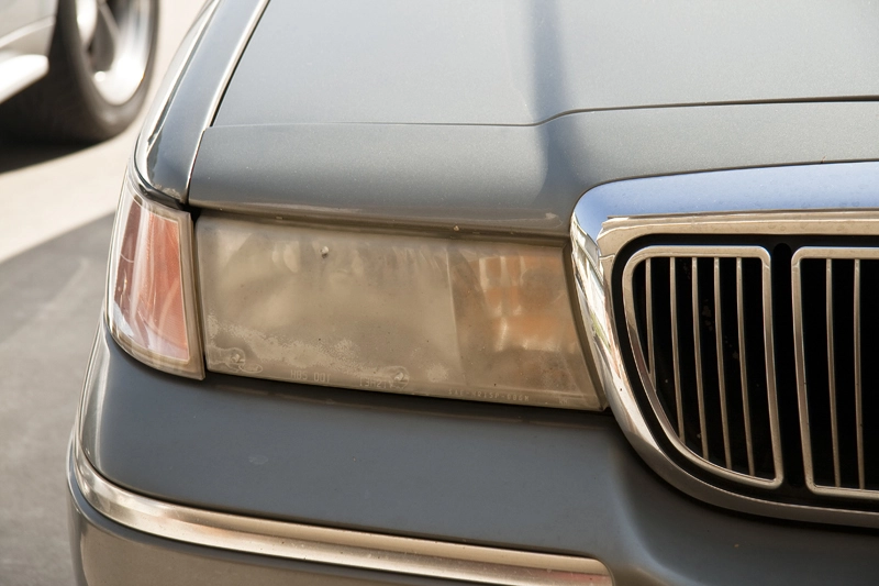

Before....

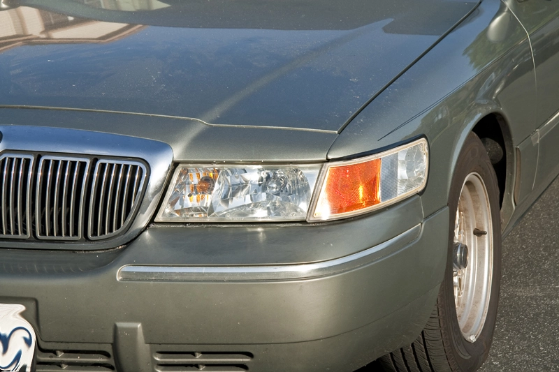

After...What a difference!!!
