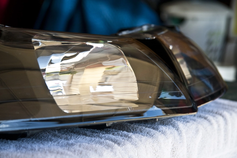

So this is the third set of Cobra Headlights I have done a restoration on.
I was at the gas station and was talking to an older gentleman about his low milage (15K) 2004 Cobra. We were talking about detailing and I noticed he had brand new Dark Smoked Headlights. I found out he still had the OEM Stock headlights sitting in his garage so I offered to buy them from him and the became mine!!!

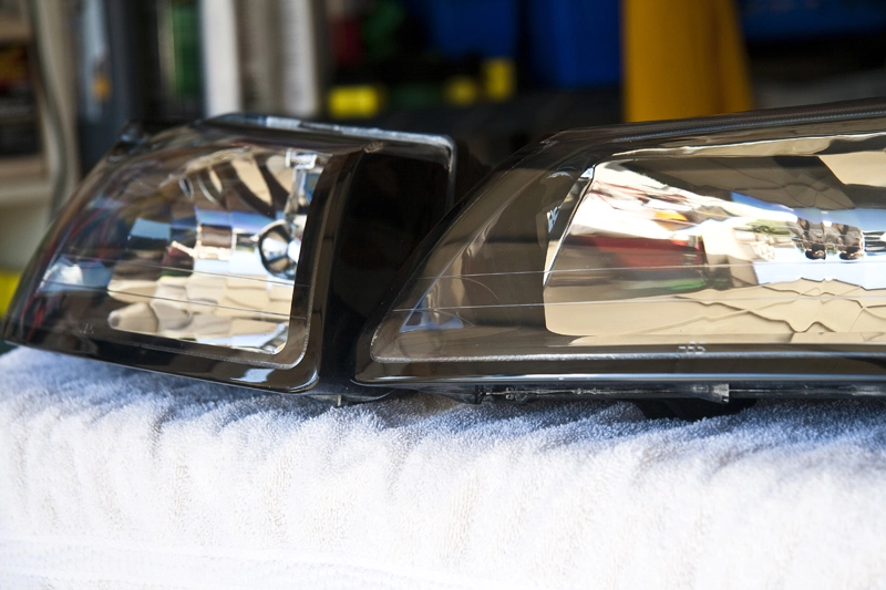

I spent a good 5-6 Days on these lights. they were already in very good condition but i wanted them show car perfect!!! I sanded, and sanded, and sanded every defect out. It took alot of time but it was well worth it.
This is the best headlights restoration I have done to date. I spent the most time even doing a light a second time to ensure then best results. The Pics speak for themselves!!!
3M Wet/Dry Sand Paper
-1000 Grit
-1500 Grit
-2000 Grit
-3M Rubbing Compound w/Hexlogic Orange
-3M Machine Polish w/Hexlogic Black
-CG Rocket Polish w/Hexlogic Blue
-CG EZ-Creme Glaze
-Menzerna Powerlock

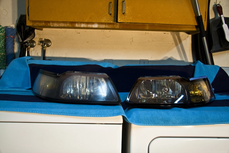

Left Side = Sanded

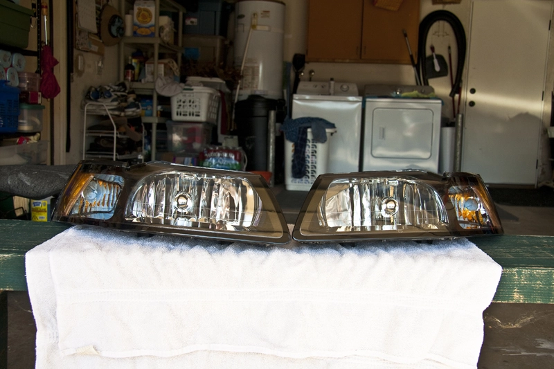

Right Side = Polished and Finished

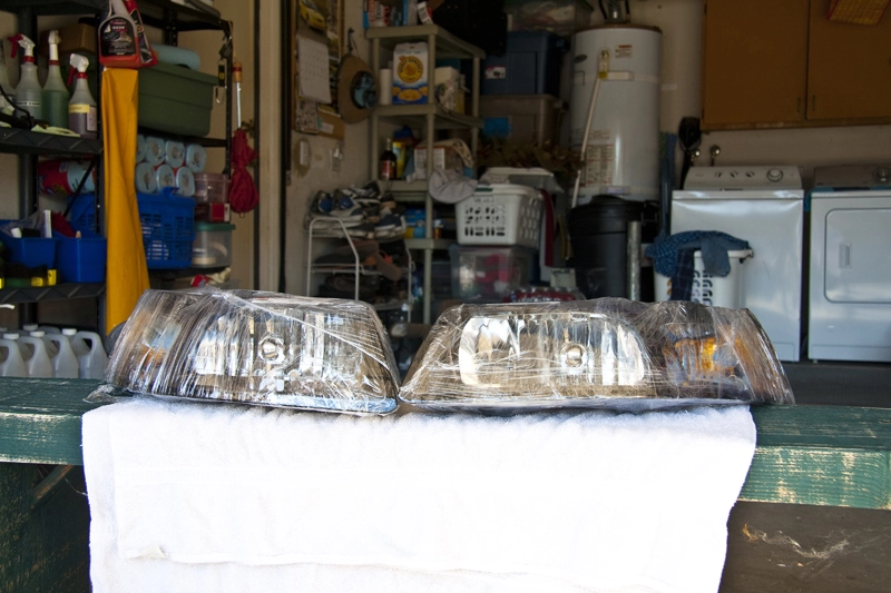

Packed, Protected and Ready for Sale!!!
