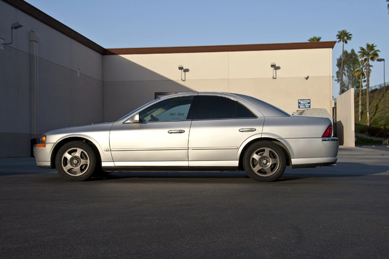

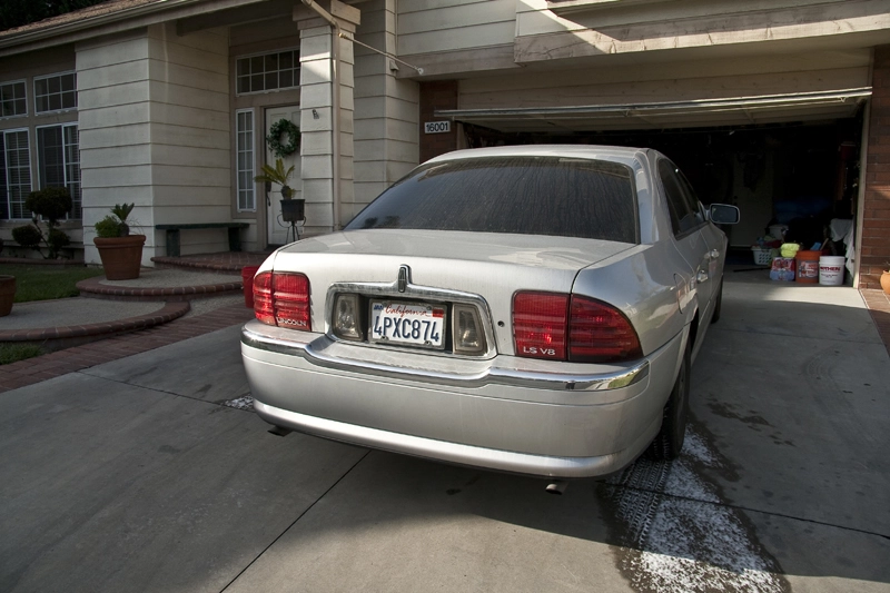

The owner of this car is a Good friend of mine. The owner Hired me to do Full paint correction on this car because, and I quote, "Handz Is Thug".
This Car is a DD. It has 120,XXX Miles on the Clock. Its lives its entire life outside and has gone through 2 motors. Car is beat on everyday in LA Traffic since Day 1 of Owning the car. Car has driven to vegas 10 or more times from LA and driven to mexico. Car sat in the Fresno dirt BS for a while.... So lots of work for me lol
This is the 3.9 V8 Model
Full Paint Correction Exterior with Headlight Restoration. Light wheel cleaning because they are Spray painted.
The owner helped me work on this job so we did it in a day and a half!!!
Silver is a PITA to find defects on and the Lincoln Paint is Rock hard.... It made this Job annoying.
Time Invested: 16 hours (2 Guys Working)

Before:

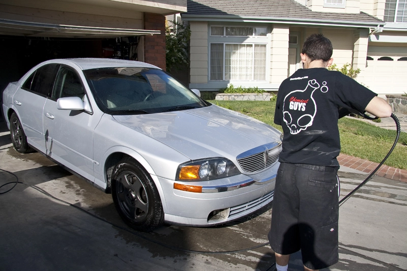

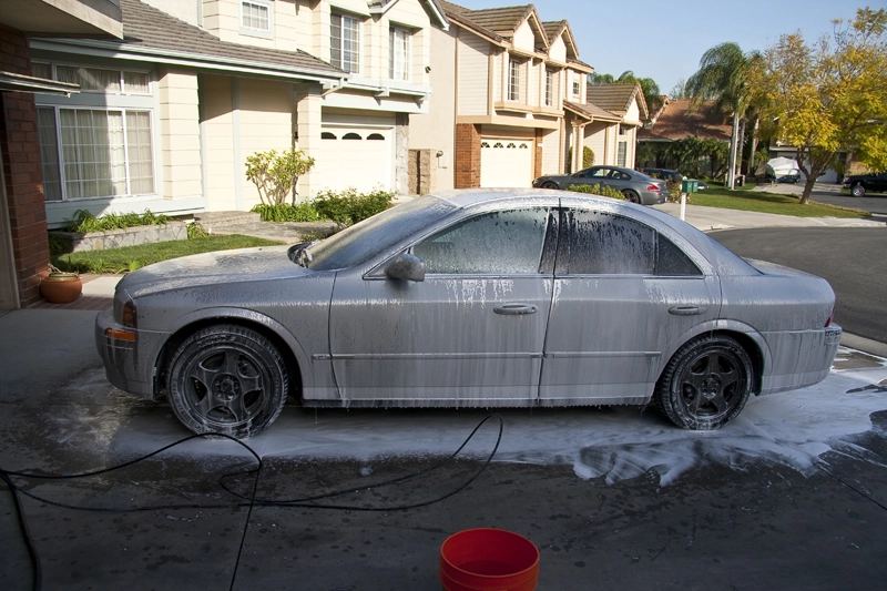

"DankFanatic" from DB Stopped by and brought his Foam Canon for me to play With!!! Hurray!!
Foam Canon: 2oz CG CWG + 2oz CG CWC + 1oz CG Orange Degreaser

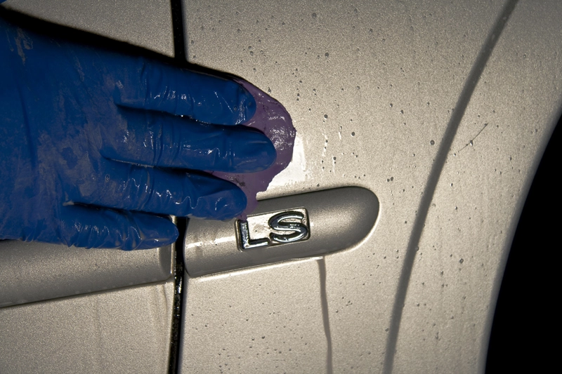

Clay With CG Heavy Clay + CG Luber

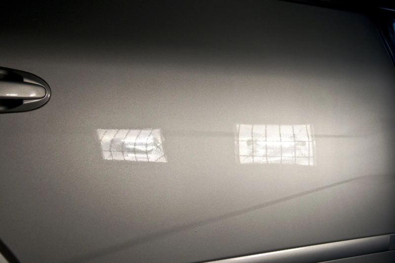

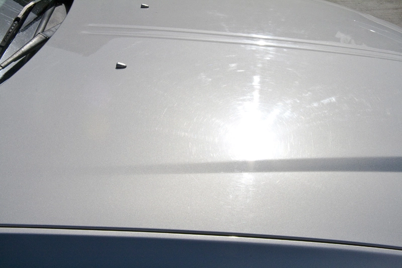

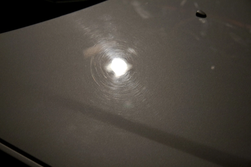

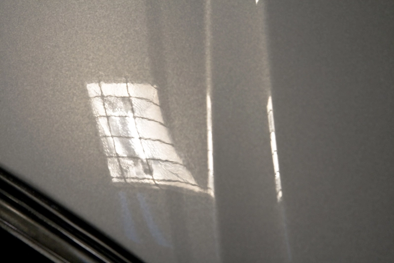

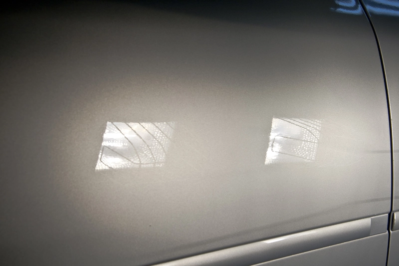

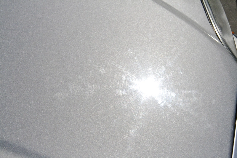

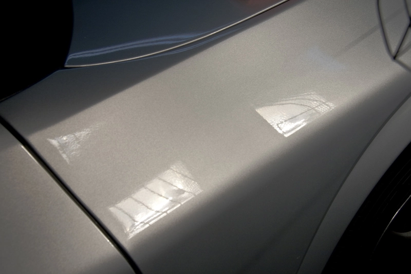

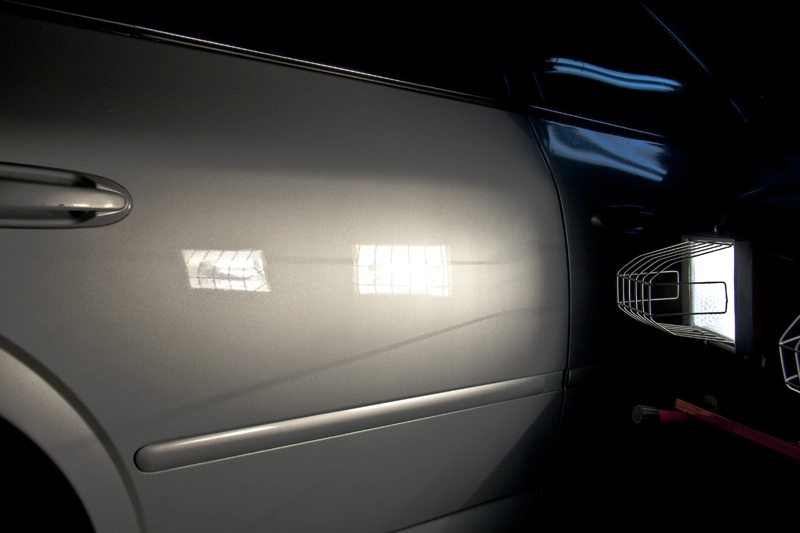

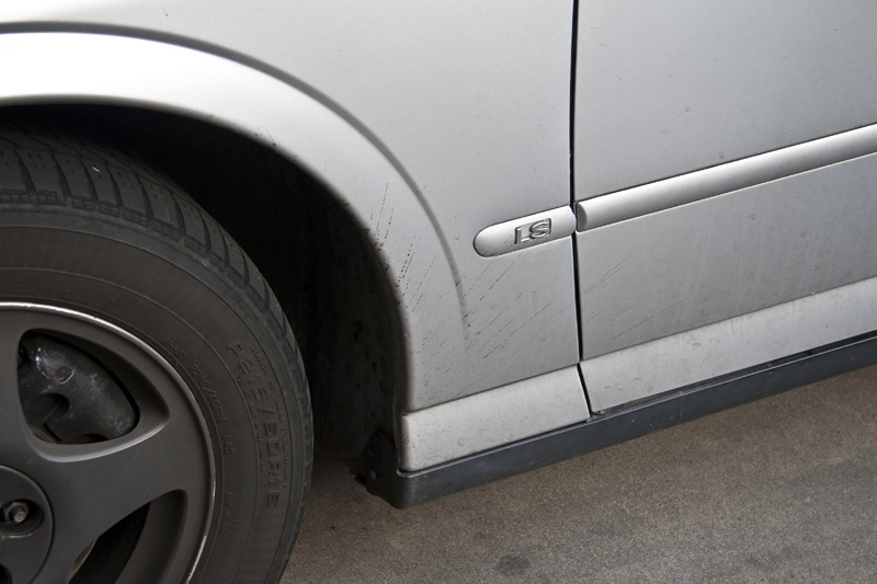

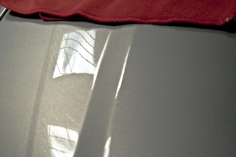

Inspection Time!!!! Nasty Swirls!!!

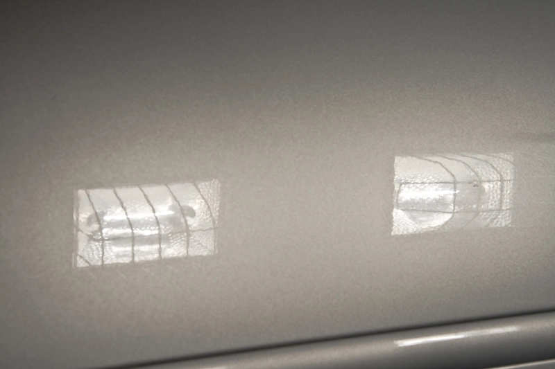

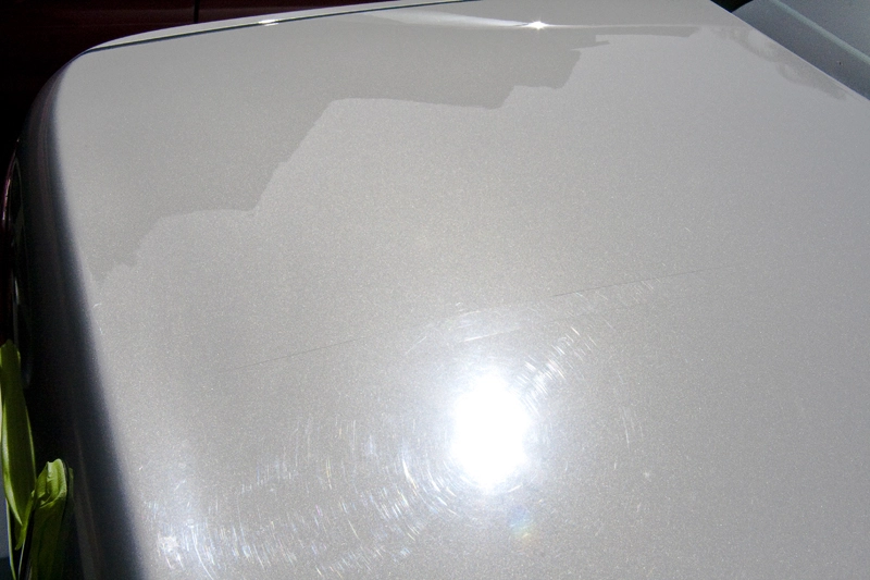

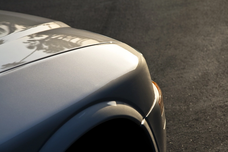

50/50 Test Panel on The Trunk

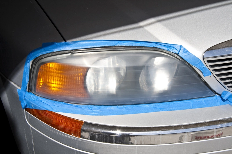

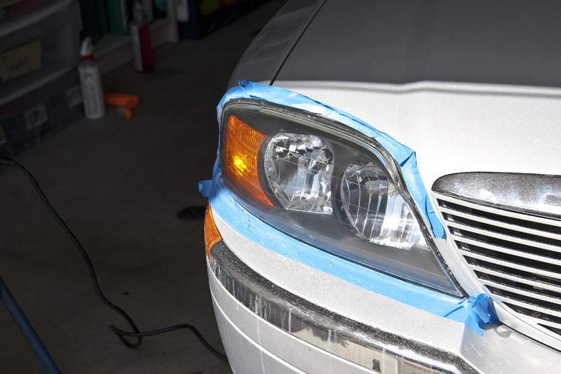

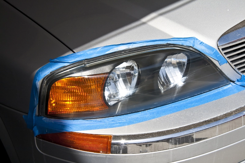

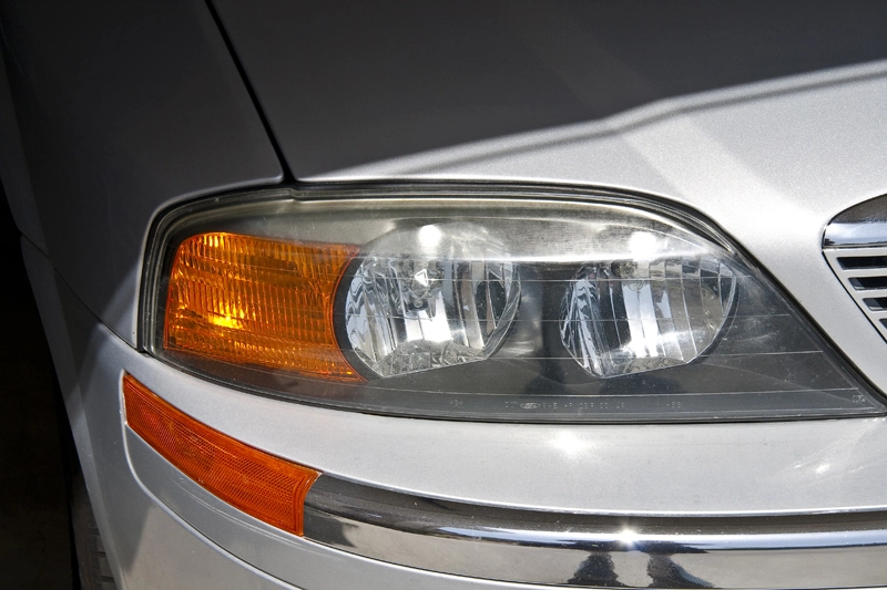

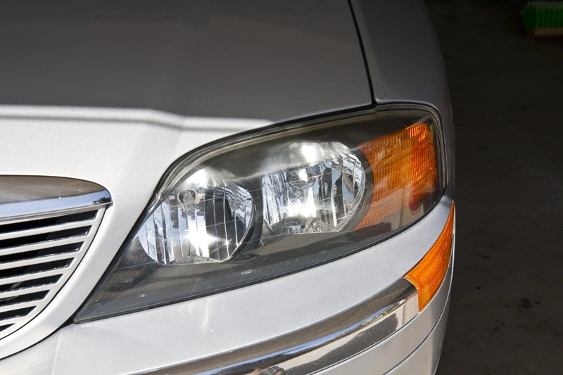

Headlights Before
Headlights After

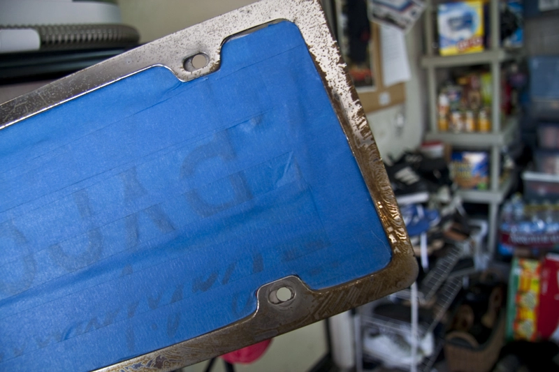

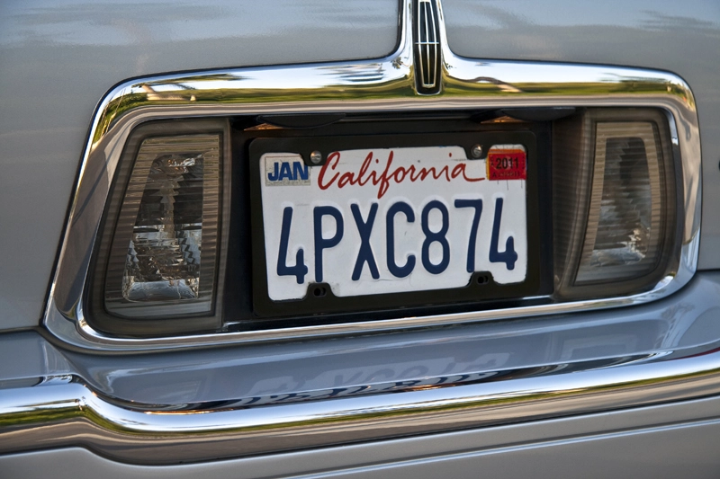

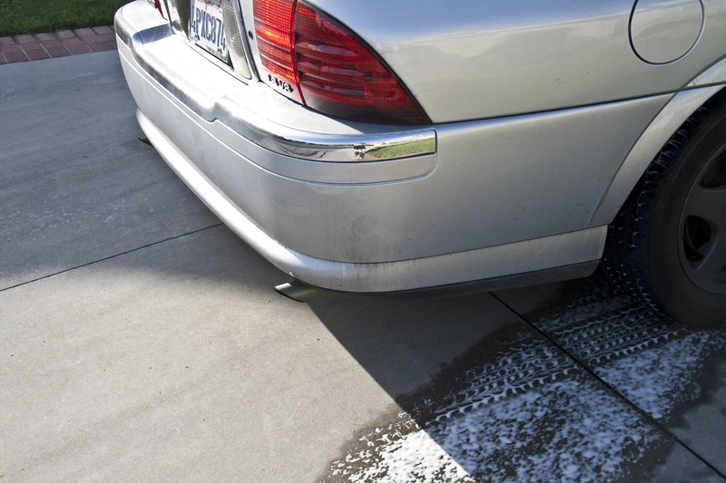

The License Plate Has a Chrome Frame that is Totally Trashed!!! We cant remove the Plate frame from the Plate because its glued to the Plate itself because the Owner has a HUGE subwoofer in the trunk and it prevents the vibration. We decided to use some Semi Gloss Paint I had laying around to make it look better!!!
Scuffed with 800 Grit
Looks Like New painted Black!!!

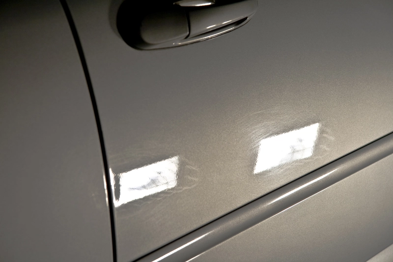

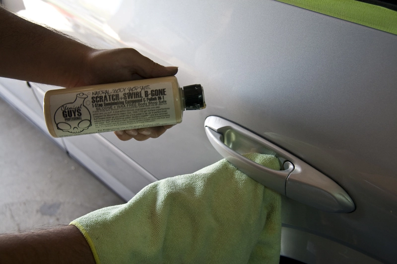

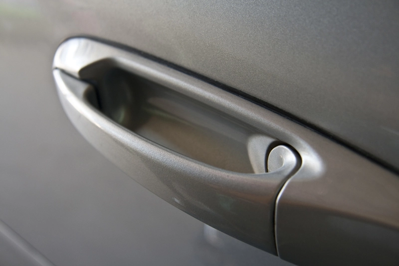

Hit the Scuffed Door handled because they were Scratched to Hell

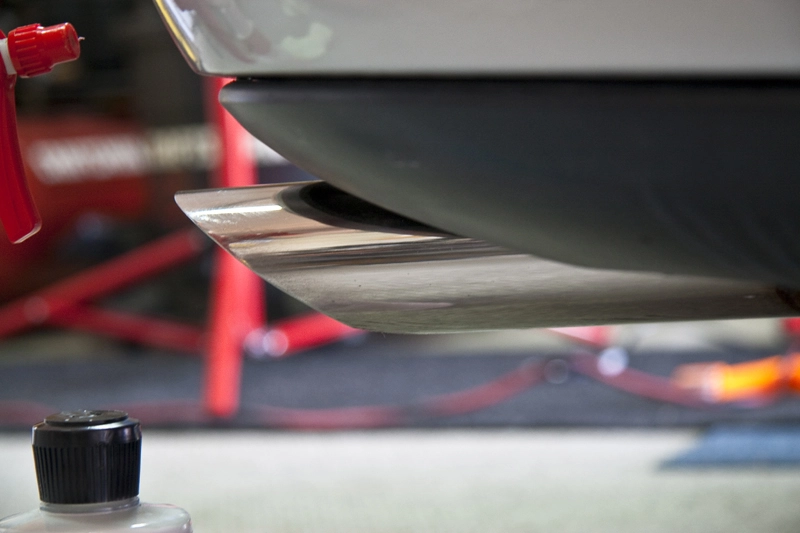

Tailpipes Before
Tail Pipes After some #0000 Steel Wool + CG Metal Shine

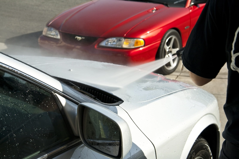

Last Rinse After Polishing to Remove Dust

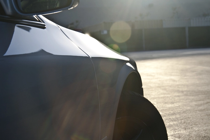

Last Inspection With The Scope

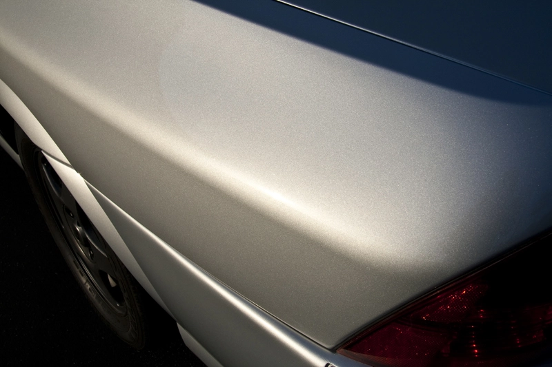

After!!!

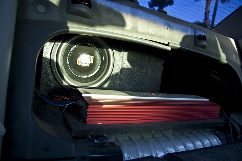

Owner Has a Big Speaker.... Hits Really *****ing Hard. Custom Digital Designs 12inch Cone with 15inch Triple Stack Voice Coil and Magnet in Custom Horn Box. 4000 Watt Amp.
Nothing Hides Under The Lights....
Headlights Before
Headlights After
