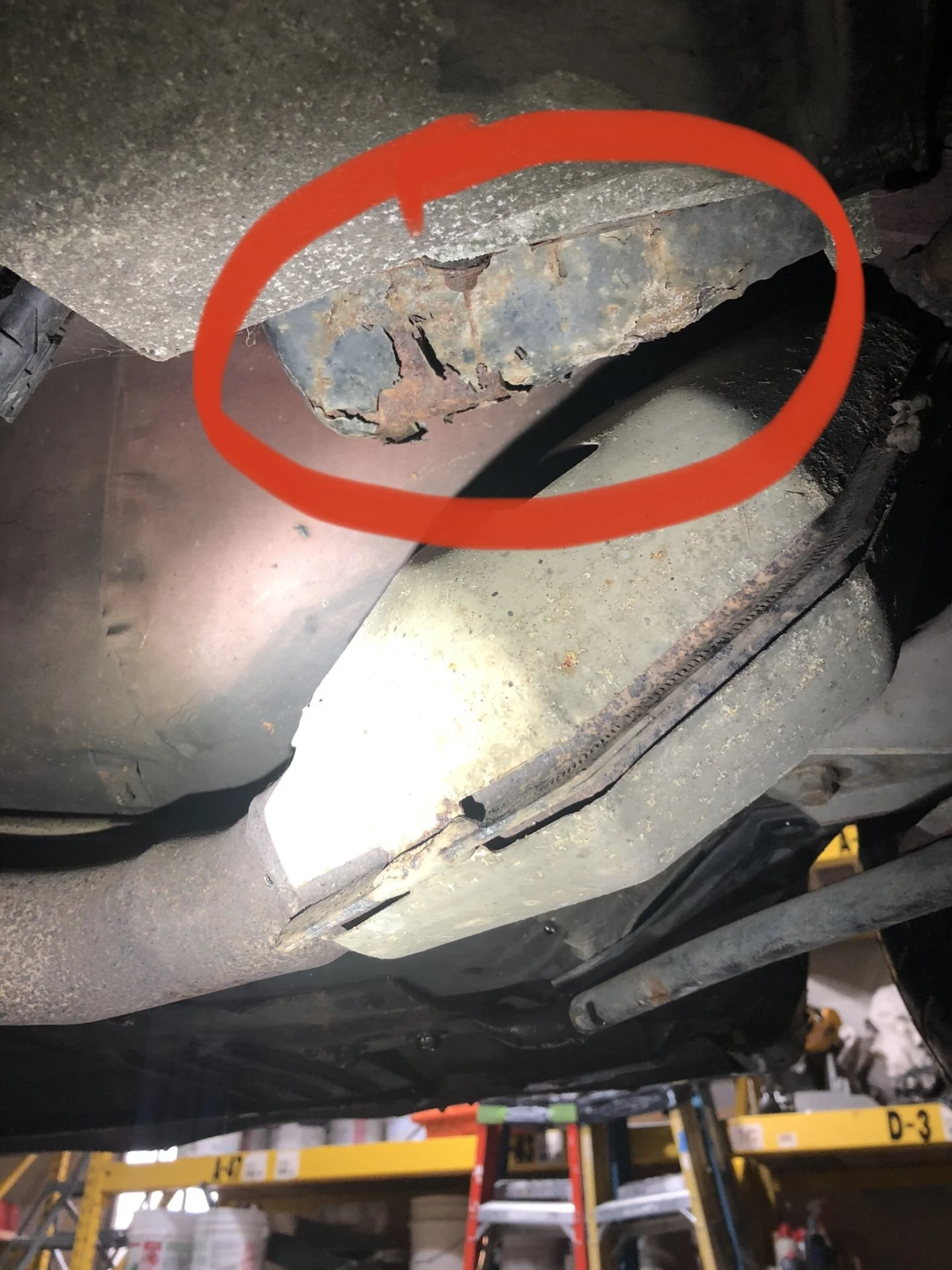

Okay. I got her on the lift today. Still can n to figure out how to post pics as they all are "too large?" Never had this problem on other forums. Anyway, I see a drain but not a fill on the gear box. Would it be the internal Torx on driver's side?
Also, what is the "factory quadtant"? I see a black box-like cover on the driver's side. Is it beneath this? Will try to upload pics
Here:

The black box in the picture looks to be what is left of the clutch fork cover. The quadrant is connected to the clutch pedal under the dash. The factory ones are made from plastic. Aftermarket are made from aluminum typically.
Have you tried to pull up on the pedal and then press it to the floor as suggested above?

Do not touch the Torx head bolt. That holds the 5-R shift lever. Removing that means trans needs to come out.
Drain and fill are on the pass side and accept a 3/8” or 1/2” drive rachet head.
