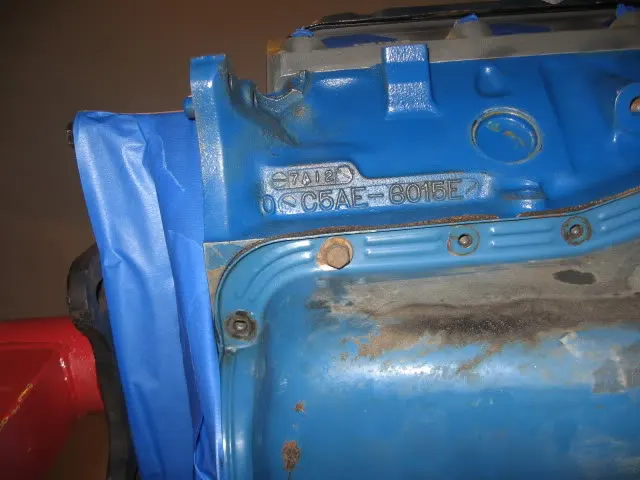

I'd verify the year of your block first.You'll probably have to remove the starter and get under there with some gunk spray, a toothbrush and rag as it's usually greasy. Look here for the casting number and date code:
The casting numbers are the bottom line, mine above are 'C5 = '65 design
The casting date is on top: 7A12 = '67(7), Jan. (A), 12 (day of cast).
Let us know what the numbers on your block are and we can narrow down your year and what wt. balancer you'll need.

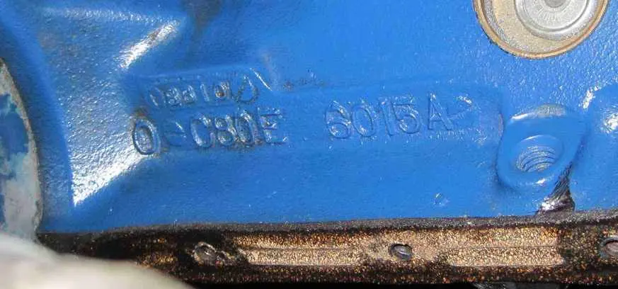

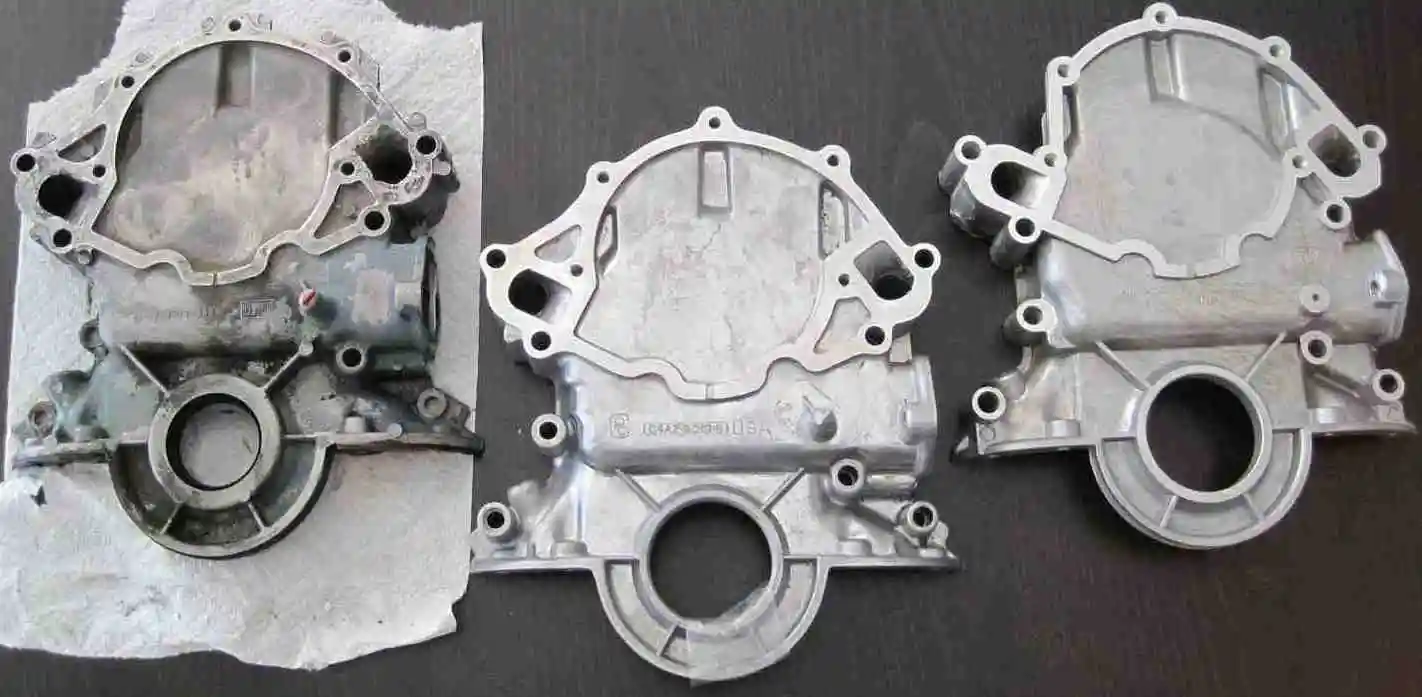

Numbers + photos
Thanks for your responses!
Was out of town, I just had a chance to yank the starter (and the oil pan, was going to do that one anyway) and checked out the casting numbers for the year. I have C8OE 6015A, which I guess is a 1968 302 block.
That Prof Products balancer looks good, but I have a fairly new original-style balancer on there now, not SFI rated and weighs about 6.5 pounds. It works Ok, but I'm looking for a SFI rated one if possible with some real heft to it.
I might have to buy some new pulleys, and I definitely need a new timing cover too since the coolant passages of the old one are all corroded. So I'd like to plan for all the related pieces at once...
My photos show the casting numbers, and the three timing covers I have access to now (original, original-style, and Edelbrock 302).
