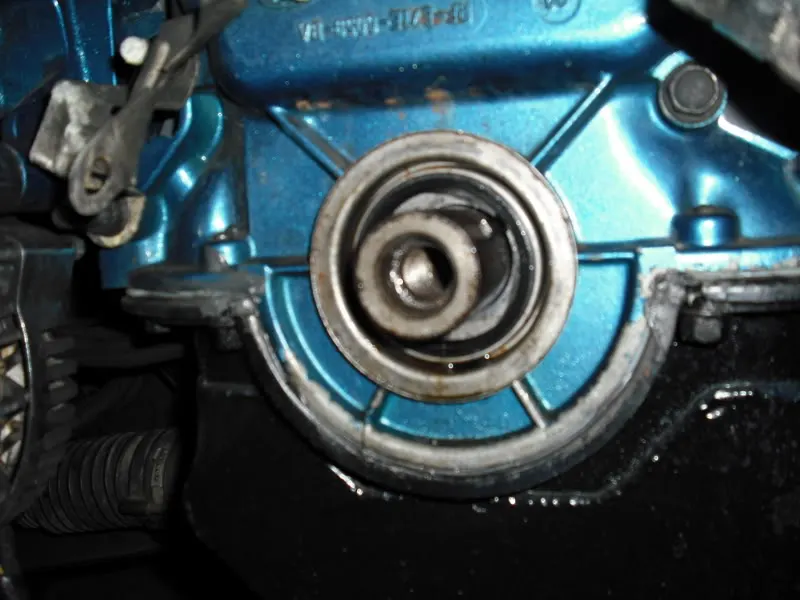

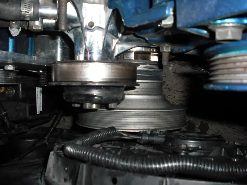

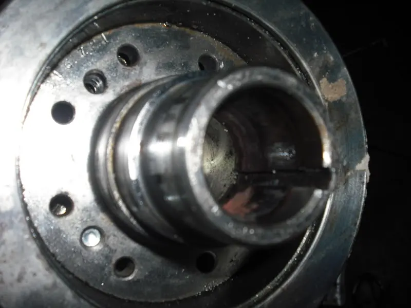

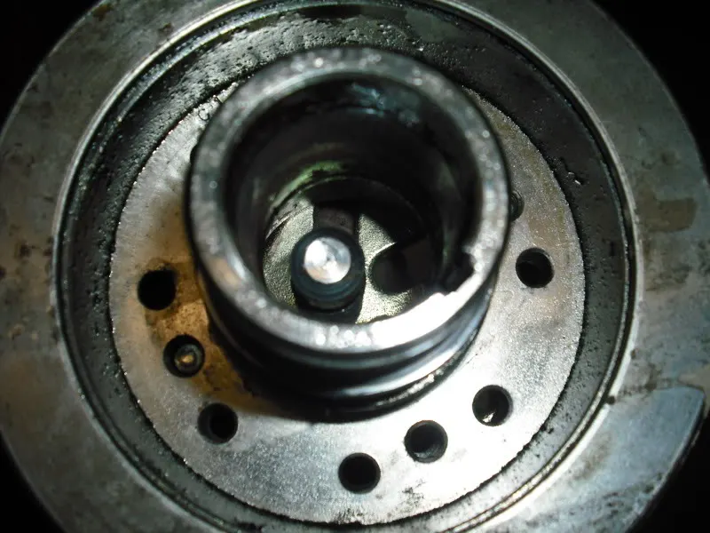

so to catch you up, i broke the snout of my old crank shaft and part of the reason was the YSI supercharger. I got the car all fixed and today I was out and bam shredded belt and the pulleys moved forward slipped off the key I assume on the shaft. Does this make sense? or if the pulleys moved forward did I break another cranck shaft?
I took some pictures of the problem , what do you think about my harmonic balancer is the key chuck too wide? let me know, im begining to loose it with this setup its always and I mean always something.
snout
Harmonic balancer
any ideas welcome

What type of balancer are you running on there? If it's a Romac, they sometimes need the inside diameter to be honed out slightly, so they can slip over the crank snout easier. It'd still be a press fit, but it just might be a little too tight, so it's not fully seating and throwing off your pulley alignment.

it is a romac, on the unit you can see in the key slot that it was under great force becuse its pushed in and the metal is bulged

Maybe I Will take this one in and have it honed out a bit. Do you think I should replace the key?

Replacing the key might not be a bad idea either, if it's out of shape now. Keep in mind that this is a 50oz balancer, too. I don't know if you're putting this on a 50oz balance. I was just using this as a reference.
