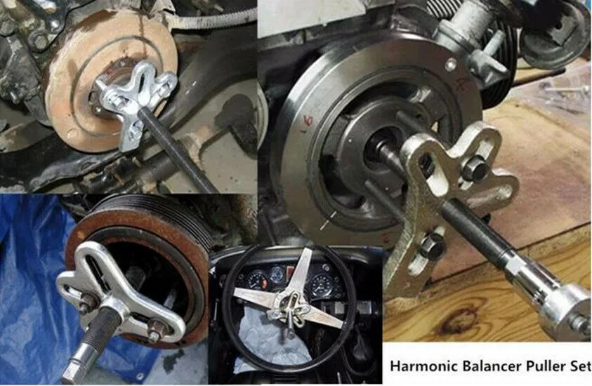

2Blue2 will be trying this sex one when I can find it Mod Dude Mar 5, 2019 4,475 2,934 163 Oahu Mar 8, 2020 #2 Mar 8, 2020 #2 They do not pry off or pound on. If you'll or push/pull on outside ring it will shear off the rubber ring. You Need a puller. Reactions: LILCBRA and Adieu
