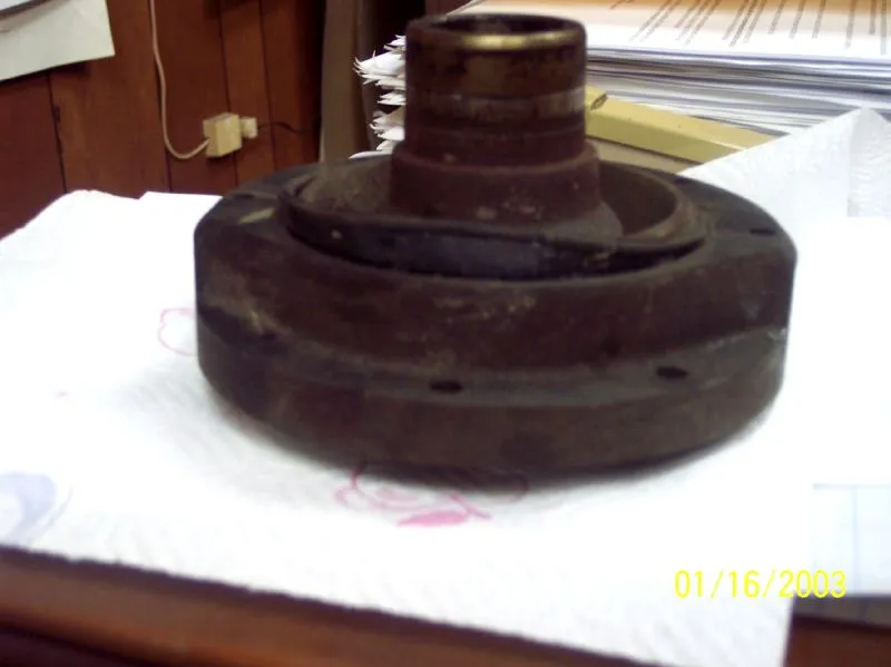

The 165k balancer. I had to order a pioneer one from advance cause the frpp one I got from summit didn't fit.
Blackened302
Jul 21, 2005
1,439
36
South TX
Feb 27, 2007
#19
  • Feb 27, 2007
  • #19
^^that don't look so bad, hehe
i'm running the pioneer one from advance--i've had it for a few months now and it's holding up really well.
gcomfx.com
Oct 22, 2002
3,690
56
Republic, MO
Feb 27, 2007
#20
  • Feb 27, 2007
  • #20
Sweet. I should have kept my first one. It was so bad, it was hitting the bottom water pump bolt.
My second stock POS, cracked at the key way. I buy the SFI Pioneer... then build a 331 and can't use it. Oh, the crazy modding world.
