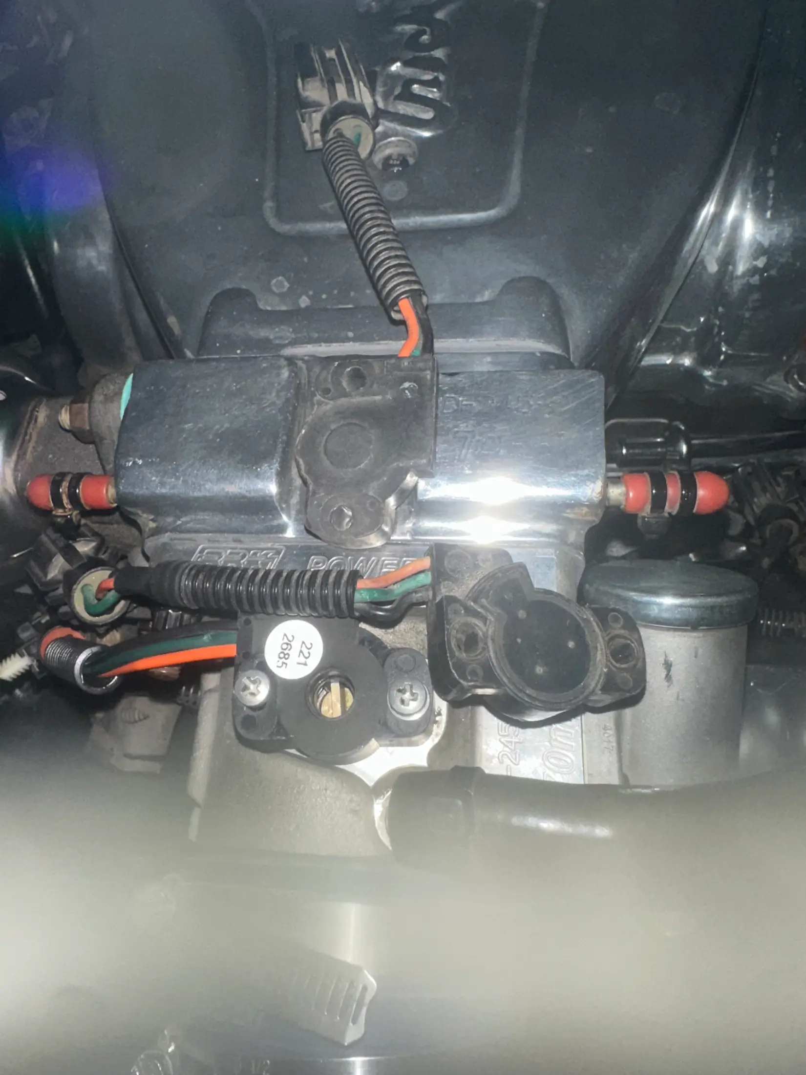

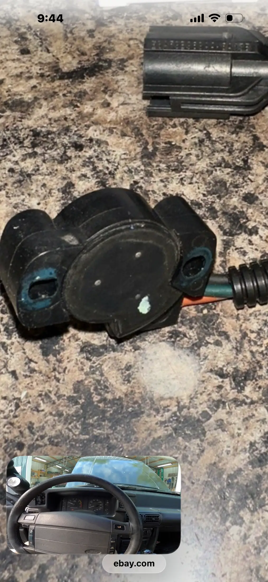

I bought a new tps. Ran smoke machine & I’m getting a lot of smoke coming out of there. I noticed my older ones have a “cover” over that hole in the center & the new one I installed dossnt . You can see the throttle butterfly in the center. In theory I shouldn’t have vaccum comming out of there correct?Any thought on that?

Vacuum does not 'come out' it pulls, but you knew this so to the question, no... You do not want unmetered air pulling through there, look for a TPS that does not have that hole.

Hole really doesnt matter its the the shaft leaking... You can fix some with a radial shaft seals, last one. I did was a cheapy China is style throttle body though, there so I don't have any part numbers to give ya for an bbk/edelbrock one.
It’s not the job of the TPS to seal its job is to sense the throttle body position. Shaft seal on the TB is leaking. You can fix it but it’s a pain in the ass as these are non serviceable units and it’s the seal bearing that leaks. Here is the forum thread that I found researching this:

AGree. There is usually an O-ring/seal on the shaft of the TB that prevents gas from passing. Over the years that O-ring disintegrates or is lost.

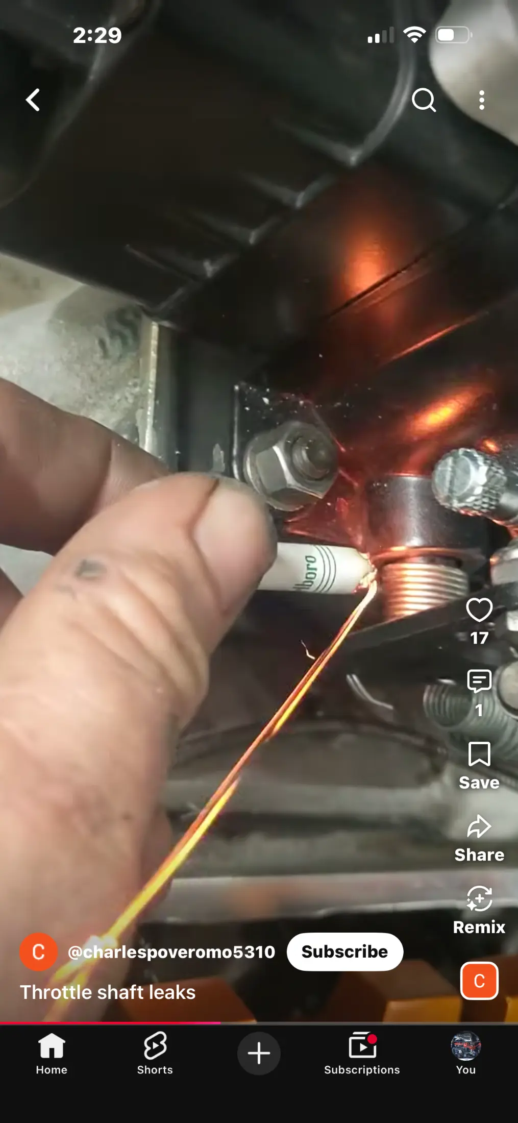

Bros I think y’all guys are right! This is my issue I’m assuming it’s considered are major vaccum leak am I right . I thought I was tripping…. It’s leaking from the bottom as well where the spring goes just like this screenshot I added. Assuming the throttle blade thing goes through the gasket & it would leak top/tps & bottom makes sense

Just and FYI, as far as I know the BBK and Edelbrock throttle bodies do not use an o-ring. They use a seal bearing and it’s a non-serviceable item according to the manufacturers. The link I posted shows how to put a seal in them. It’s a lot of work and these units are not all that great.

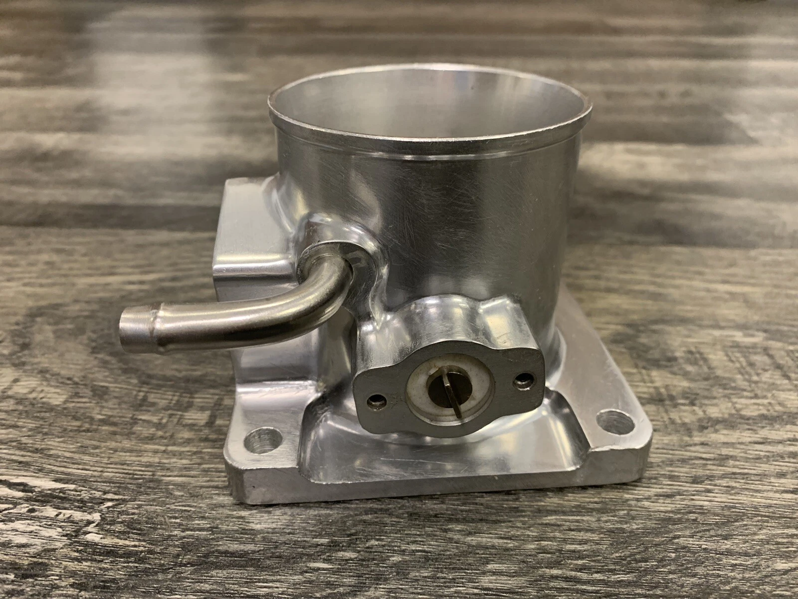

Looks like someone is blowing out Macs old inventory and they have the 70mm.... Looks like it has a teflon seal on top of the bearing in the pics?
