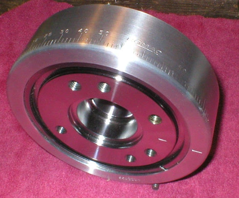

With the $$$ you're putting into that mill, don't scrimp on the balancer.
Romac. :nice:
