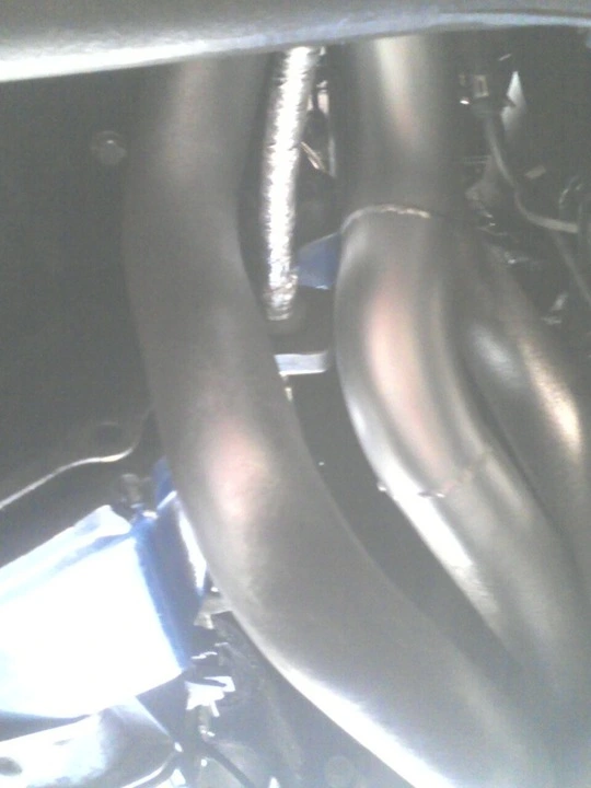

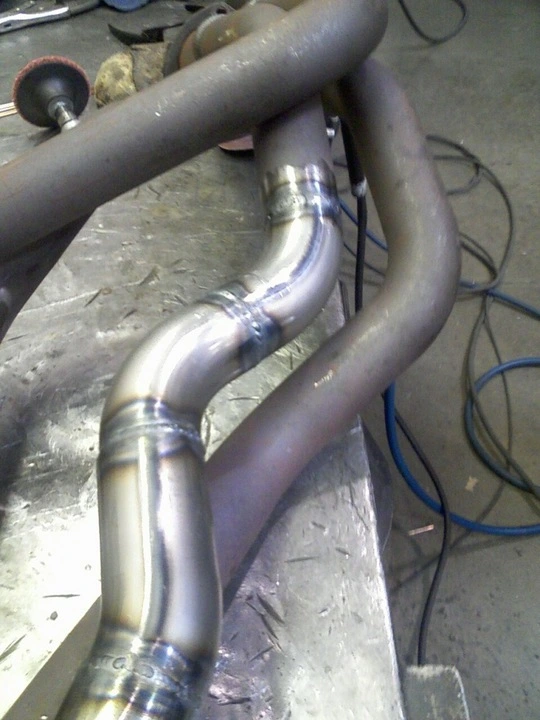

I run the hedman 88300's on my 66 mustang..and the cable hit. I took the car into my friend and had him cut and relocate one tube.
The resulting effect was that I have a straight shot into the bell housing now with no kinking and no zip ties.
It does come pretty close to the two pipes but it does NOT TOUCH!!!!. I'm hoping between the heat reflective tape that I'm using, and a spark plug boot that I am going to wrap around the cable..that I'll have no issues.

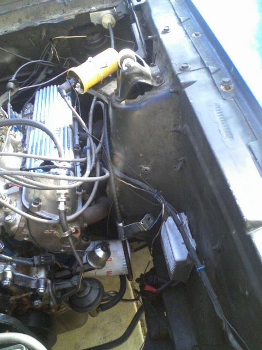

I have the heddman headers as well. I'll have to see which ones I have in my '66 cause my cable comes nowhere near the headers. I also have it routed through the fender apron on the drivers side so that could be it too. I'll snap some pics and post them up.
