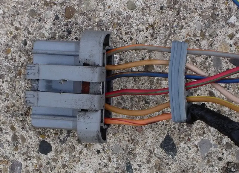

Not sure if this will cheer you up, or bring you down, But my swap using stingers instructions went perfectly, I ran it for about 4 months of the hottest summer before a CEL started popping up, But i dont think its related to the swap, i beleive my computer is bad since the car runs the same with the light on. The only advice about stingers swap i can give is the Igntion harness. The wire colors are slightly different in a 92 then they are in a 91 which is what he used to write the swap, but i figured it out. if you want i can dig up some pics i took of my completed TFI plug if you want to try to match yours up. Let me know what i can do to help.

here is what my final Working TFI plug looks like.
Maybe this will help??
Dr.

Something that comes to my mind is the variations in wiring harnesses.
My 90 Gt has a 91 wire harness, from the factory. My car was built in late 90, and they must have run out of 90 harneses by the time my car came down the line.
This threw me off for a couple of days because a couple of wire colors were switched, or just different. Pin locations were different too.
For example maybe you have the ECT sensor feeding into the computer as the O2? :shrug:

The ECT being hooked up as an O2 was just an example of how bad things can get if you are working to the wrong wiring diagrams.
All I am suggesting is double checking that you are using the correct diagrams, because sometimes the year (on the title or per the vin) is not what the car was actually built to.
