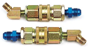

I alway use braided lines and fittings, assemble them myself so I can route them the way I want. I also like the B&M Supercooler, you can never be too large. You need to buy the braided line with the teflon inner, and the special fitting for use with trans fluid. They make quick disconnects for use at the tranny they work great but you need to massage the tunnel for easy access.
It's basically like what you have on a compressor hoes. I'll try to find a picture of them. well I found a pic from jegs. I don't have this brand but same thing.
