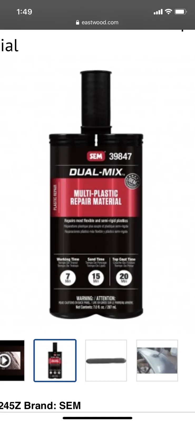

I had the windows out when I did the body work and had it painted earlier this year. SEM sells plastic repair kits that work well. I used that, we use it in the body shop on bumper covers. I block sanded the rubber surround with 180, applied the filler material, blocked that down with 120, primed them, then wet sanded the primer with 600 until smooth. Painted them with black base coat and cleared it a flat clear.

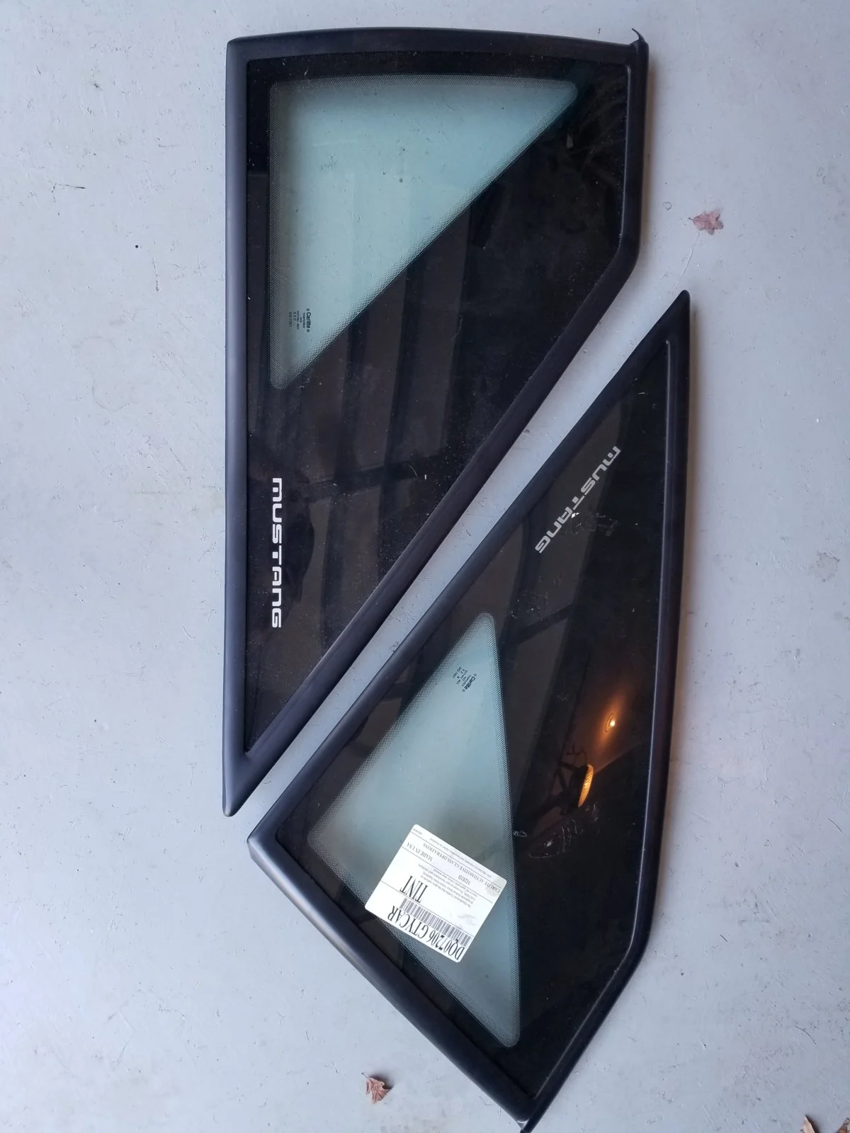

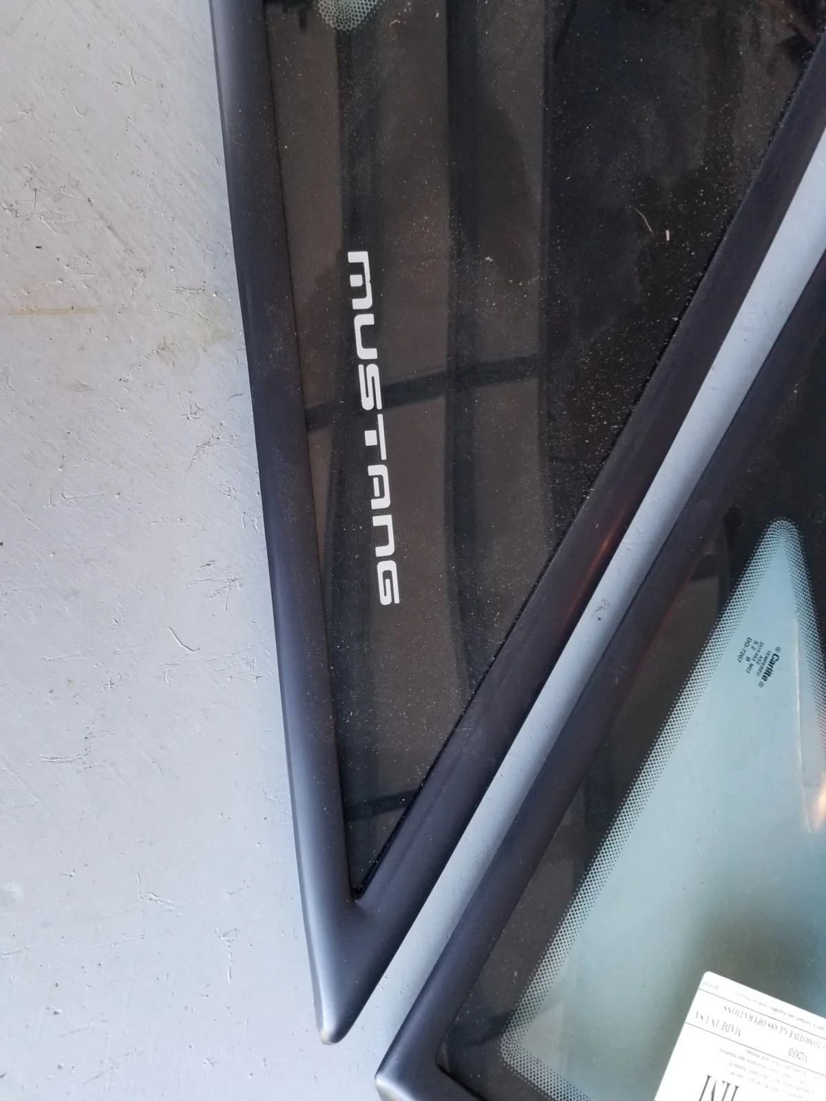

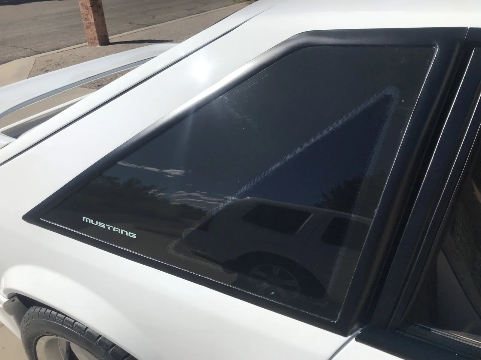

You could always redo them yourself. I did mine back in the spring. Not 100% stock looking but they look good
I did a similar restoration on both my cars. The only noticeable difference is that there is a character line in the rubber molding that is generally lost in the sanding process, and I do not see a reliable way to keep or restore that line. From my perspective, it was an unimportant detail for my higher mileage cars. If you had a low mileage car that you were restoring (or something more valuable like a 93 Cobra) then I could see spending the extra for NOS windows. For the rest, I think the sand/primer/paint method is perfectly reasonable, still looks good, and only the most hardcore Fox fans will ever notice a difference.
