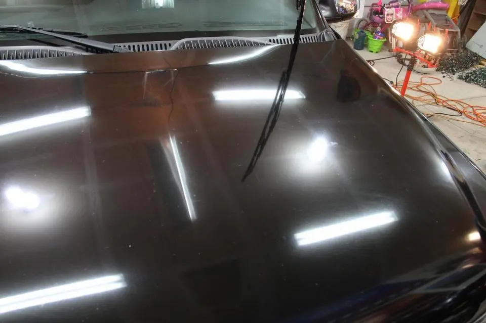

Here's what I started out with:

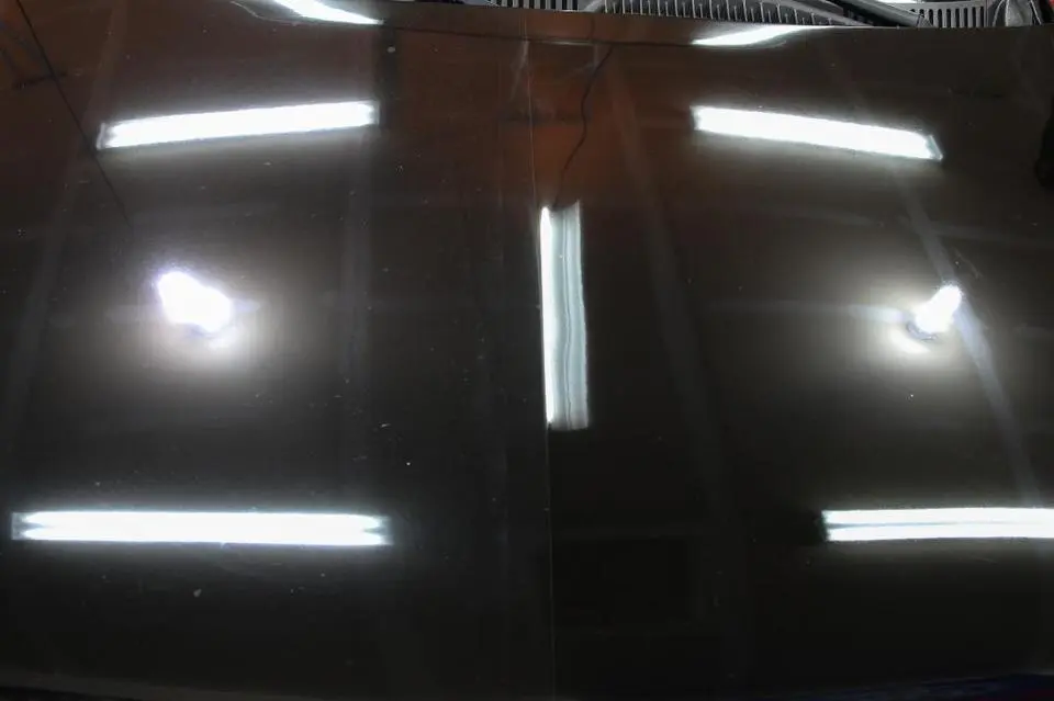

And here's what I ended up with on the right side after applying HD Speed using a Rupes with a 5.5" flat white Lake Country pad:
To say that I was impressed is an understatement. I ended up doing the rest of the vehicle with HD Polish as that did work better at removing the defects and the truck was getting a sealant anyway. But I felt this stuff did a pretty awesome job of cleaning that paint up for not being a dedicated polish product. Just like their polish, Speed went on smooth and thin and has to be one of the quickest and easiest products I've ever buffed off a vehicle.
