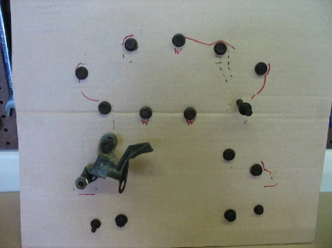

Heres a small tip....grab a box and stuff your timing bolts in place as you remove em...I replaced the w/pump at the same time....had like 20 freakin bolts... :nonono:
The bottom 4 are the oilpan bolts...
SMALL TIP? That looks like a really GOOD tip..Those bolts are always ALL over the place, and there are always 1 or 2 left over :(

rio ive never thoguht about laying the bolts out like that in cardboard :hail2: im definatly gonna remember that when i do my t-moss lower and any other engine work... i usually set them on a bench in order that i took them out and hope i can remember what bolt goes in what hole
Sseriously that's an awesome tip and the kind of thing that makes this board/forum worth reading.......... thank you! :flag: :flag: :flag:
Luckily with the water pump the bolts are all different sizes, so if you do forget where they go, it's not too difficult to figure out which bolt goes where. I know this because I didn't catch the tip about marking where they came from until after I had them all out and bagged up :D.
