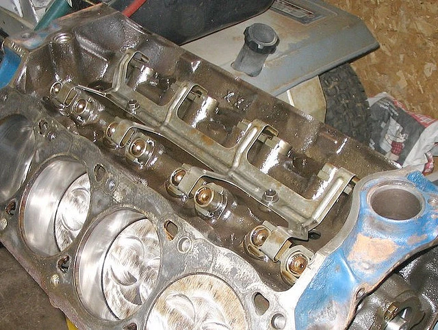

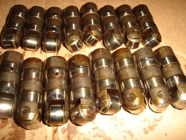

Got the drivers side head torqued down last night. The lifters have a little notch on the side of them. As seen in this picture below:
Which way do they go in? Notch toward the heads? Or notch towards the center of the block?

The notches in the lifter are there as guides for the "dog bones" to keep them from rotating.
They slide into place, with the flat edges of the notches running parallel to length of the heads as seen below.
EDIT.....
Nevermind. I see now you were talking about the small oil jet type notches on the sides. It really doesn't matter what direction they're faceing. I've seen them come out of engines that have never been apart facing both directions.
