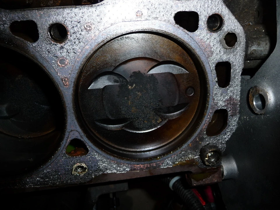

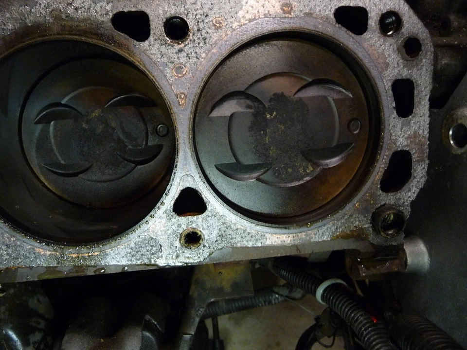

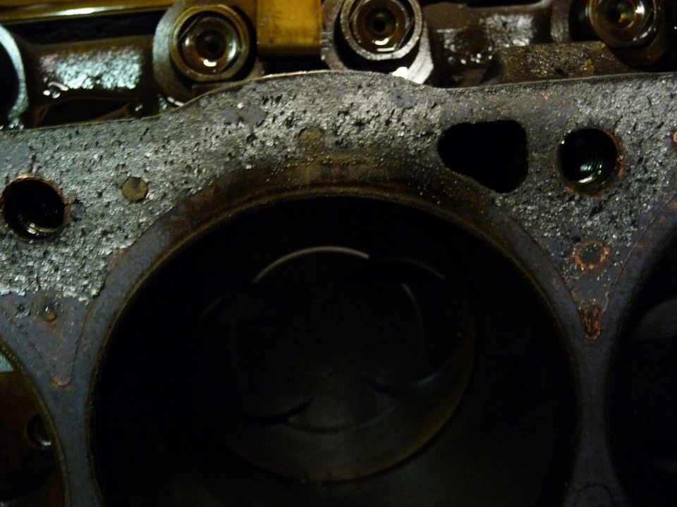

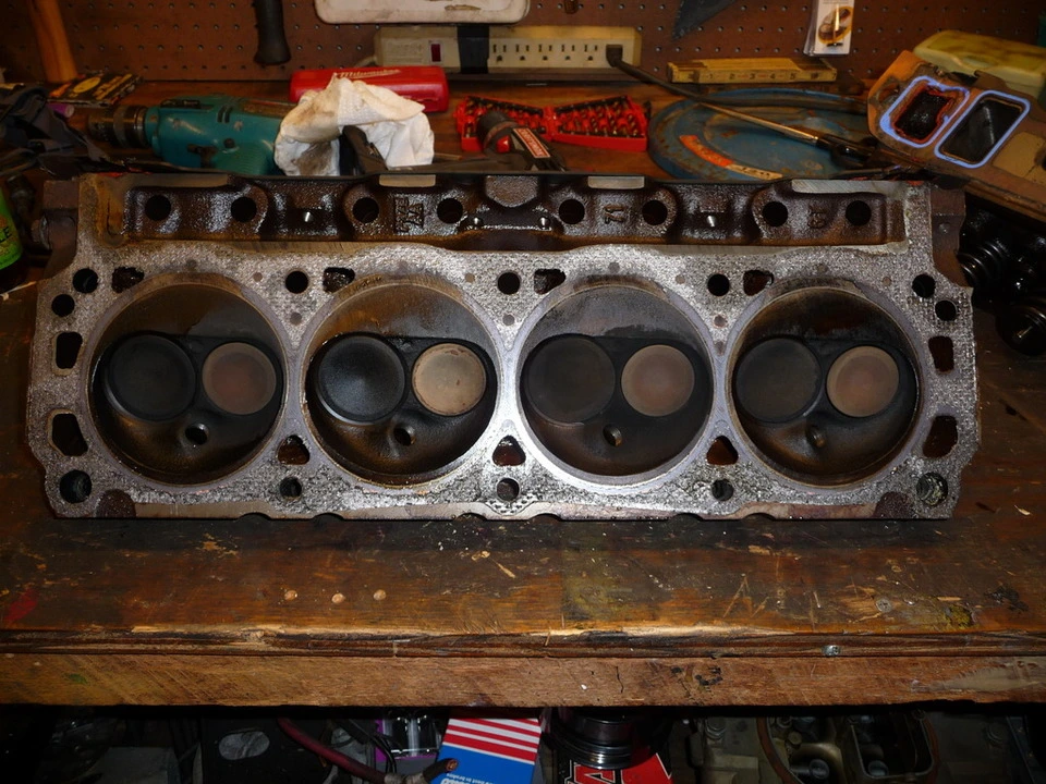

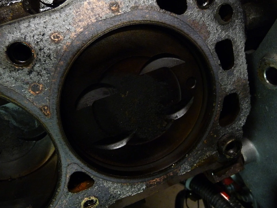

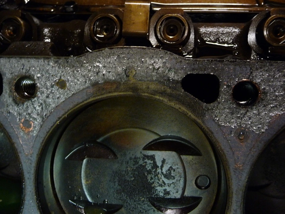

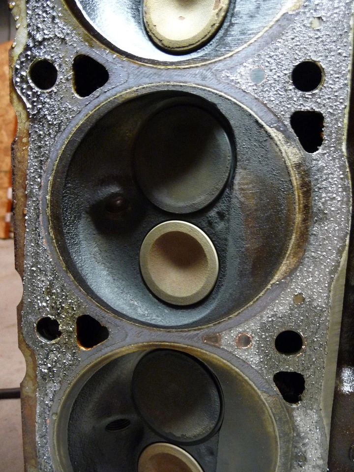

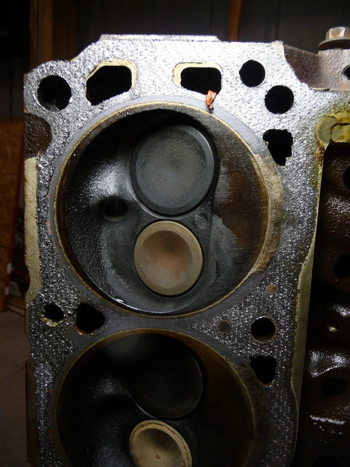

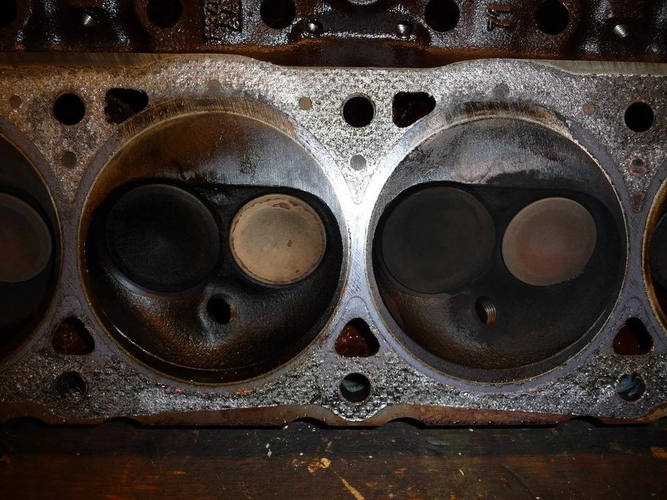

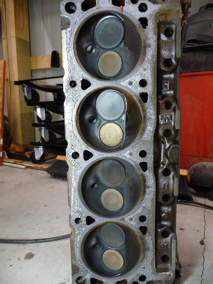

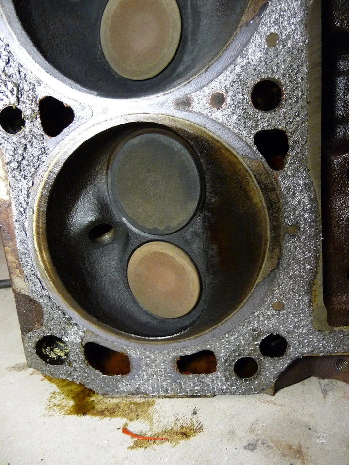

Finally got the heads off. This is a first for me at pulling heads in suspect of failed gasket due to boost. I'm not an expert here but I think what I see is pretty conclusive. Have a look and tell me what you think. Only Cyl # 1 was holding on good. # 4 hanging by a thread but all others were pretty much goners.
Here's # 1 holding. The rest look bad to me. Please confirm.

These heads were milled .012. The intake was not milled. Is it possible the intake was not allowing the heads to be free in expansion and contraction, thus lifting on the top side?

I wouldn't think so. Once you have the block clean take a known good straight edge and check it for flatness.
Just my .02 I torque my heads with arp bolts in 3 steps 45#, 65#, 85#... might seem excessive but I have never experienced a failure.

The gaskets which just had this failure are the 9333PT1's. Looking at the surfaces sure looks like head lift contributed since the top sides of most compression rings are blown through in a similar pattern on each of the cylinders. Can head lift really happen at 10psi? I need to understand what happened so I don't keep going through this again. I must have really screwed up the torquing of these heads or something.
After verifying surfaces are flat, I might go with Cometics and ARP studs. I'll copper coat the Cometics to help get a good seal. I'm considering ordering thicker Cometics to offset the fact my heads had previously been milled .012. Hoping this might drop the compression back closer to stock and also help with intake match.
Any thoughts on this idea?

By the questions you're asking, is detonation what you're thinking? Not likely all things considered. Most likely is poor job of tq on the stock bolts.
I'm just torn between trying the 9333 again or trying Cometic. Either way I'll use arp studs. I'm sure my tq specs will be correct this time. I'm not sure they were correct last time.
