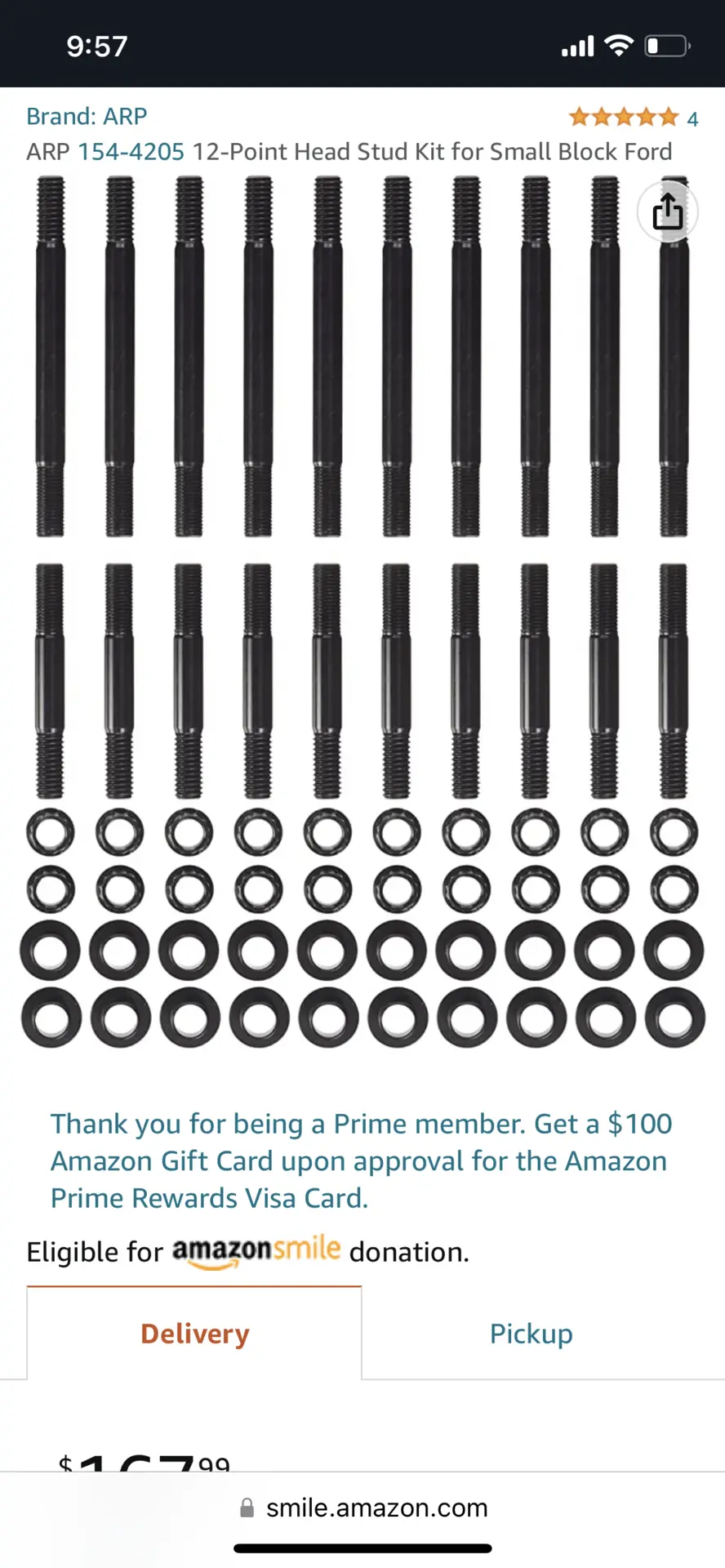

These head studs:

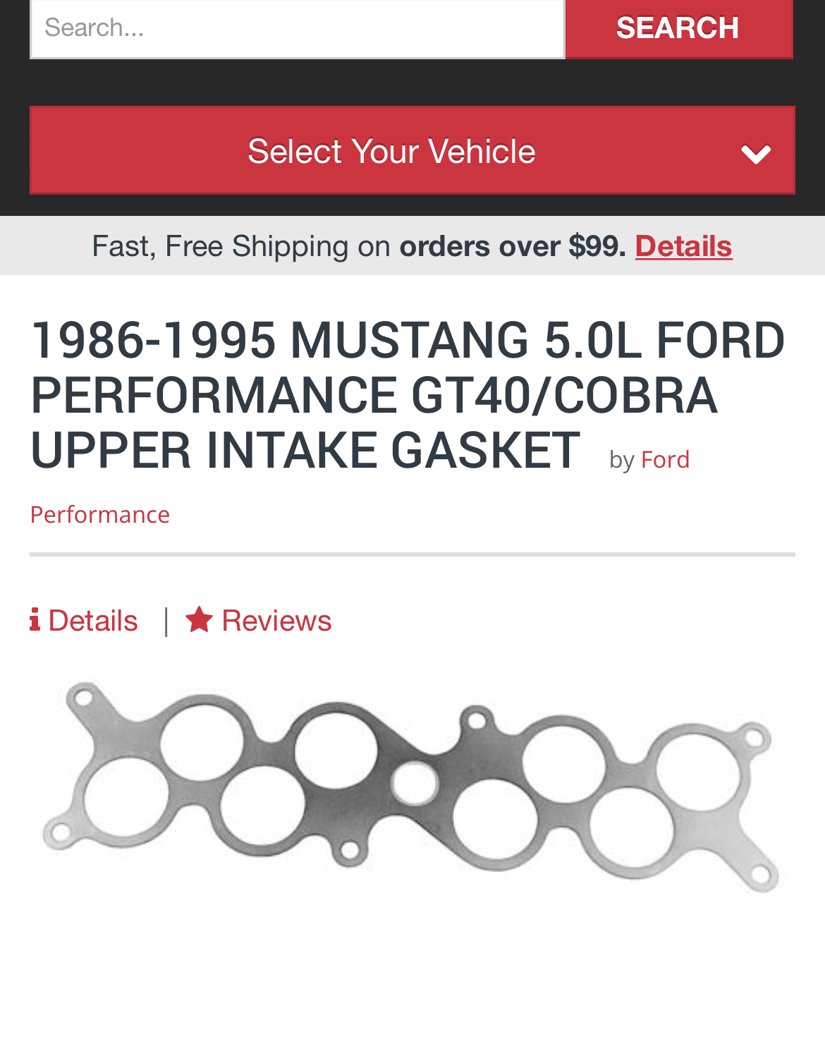

And will this upper gasket work for my Cobra manifold?

You need the intake gasket set for a 96 ford explorer with a 5.0 for the cobra intake. The upper intake gasket has 8 ofset circles not ovals like your pic.
There are 2 small black ford blocks....the 302 ( 7/16 ) and the 351 ( 1/2 head studs ). You need 7/16 head studs for a 302 - aka 5.0

Head studs, noted on size. Thank you again. I think I’m looking at ARP part # 154-4005.

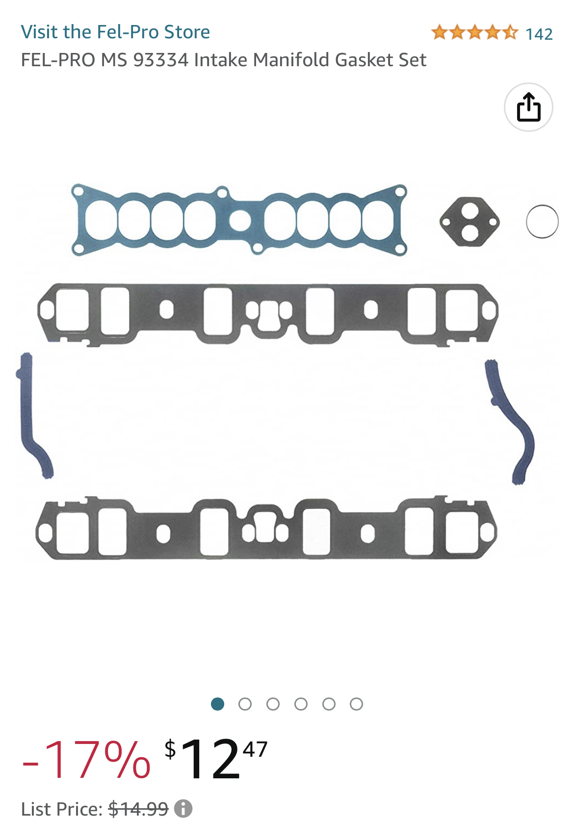

And for gasket:
Is that correct?

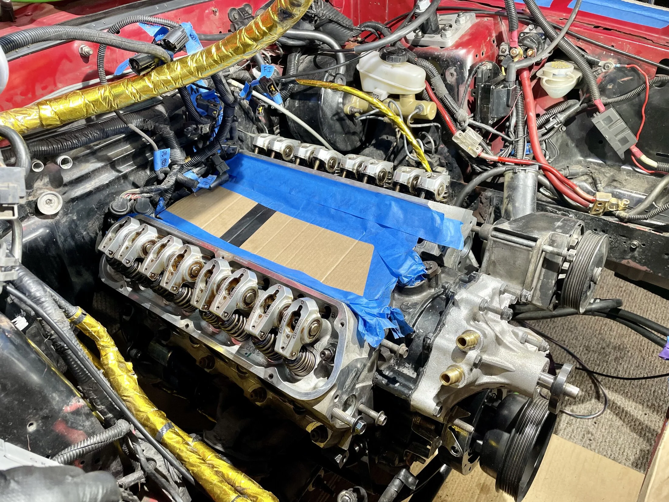

Hey bros! Here’s where I’m at. Still waiting on some parts to arrive, but I’ve been taking my time anyway. Also, once you start to pull at a thread, half the sweater comes apart.
I’m ready to remove the heads, but I’m a little unsure on order of process. The motor is at TDC on #1. I was going to start unbolting the rockers. The rockers under spring pressure; should I buy a valve spring compressor, or is it ok to just turn the motor by hand and return to TDC #1 later?
Or am I wrong on all counts and my motor is now going to grenade the next time I’m standing nearby?
Many thanks as always!

get the intake gaskets with the steel insterts- either 1262s or 1250s depending on the heads. Throw away the china wall gaskets and lay a nice bead of Right Stuff. Put assembly lube on the washers and bolts The ones that go into the water jacket get pipe dope/thread sealant. Make sure to clean the deck surface and the heads. Do not use a scotchbrite pad. use some razors and brake clean and shop towels . Check the deck and heads for straigtness with a large straight edge and a afeeler guage. if memory serves me right you want under 3 thousands clearance or mill the heads .

So after I got the heads off, I believe I found the issue. When I had the stroker put in, the builder reassembled the entire long block as well and apparently did not use any RTV anywhere besides the china walls. None of the water jackets had RTV, though. Now I’ve beat on this car for the last 7 years, so I guess I’ve got my moneys worth out of it.
The plus side was that the old gaskets both came off in one piece with fairly minimal residue left on the heads and block. Cleanup was also fairly easy as a result.
I started putting the studs in last night but didn’t finish. I’ll snap some pics when I get all the studs in, still waiting on some of the other new hardware as well.
