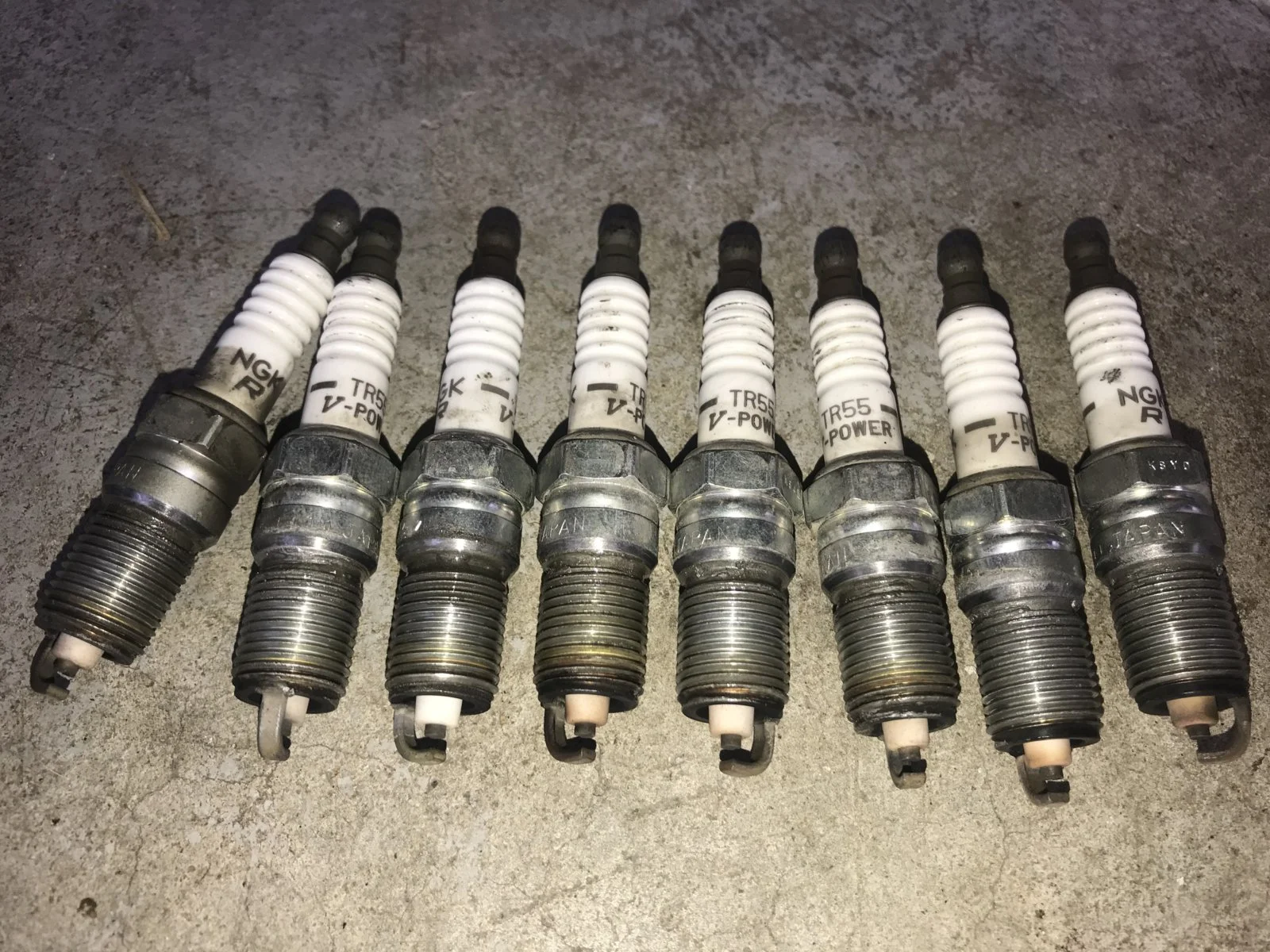

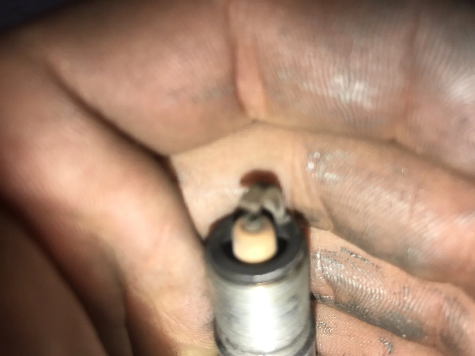

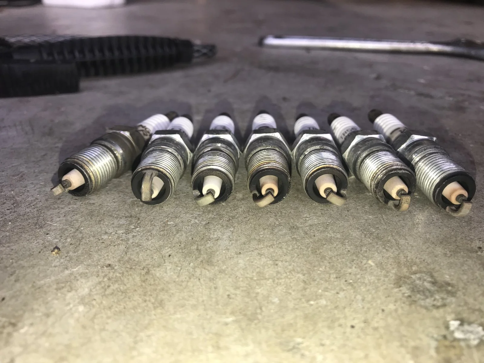

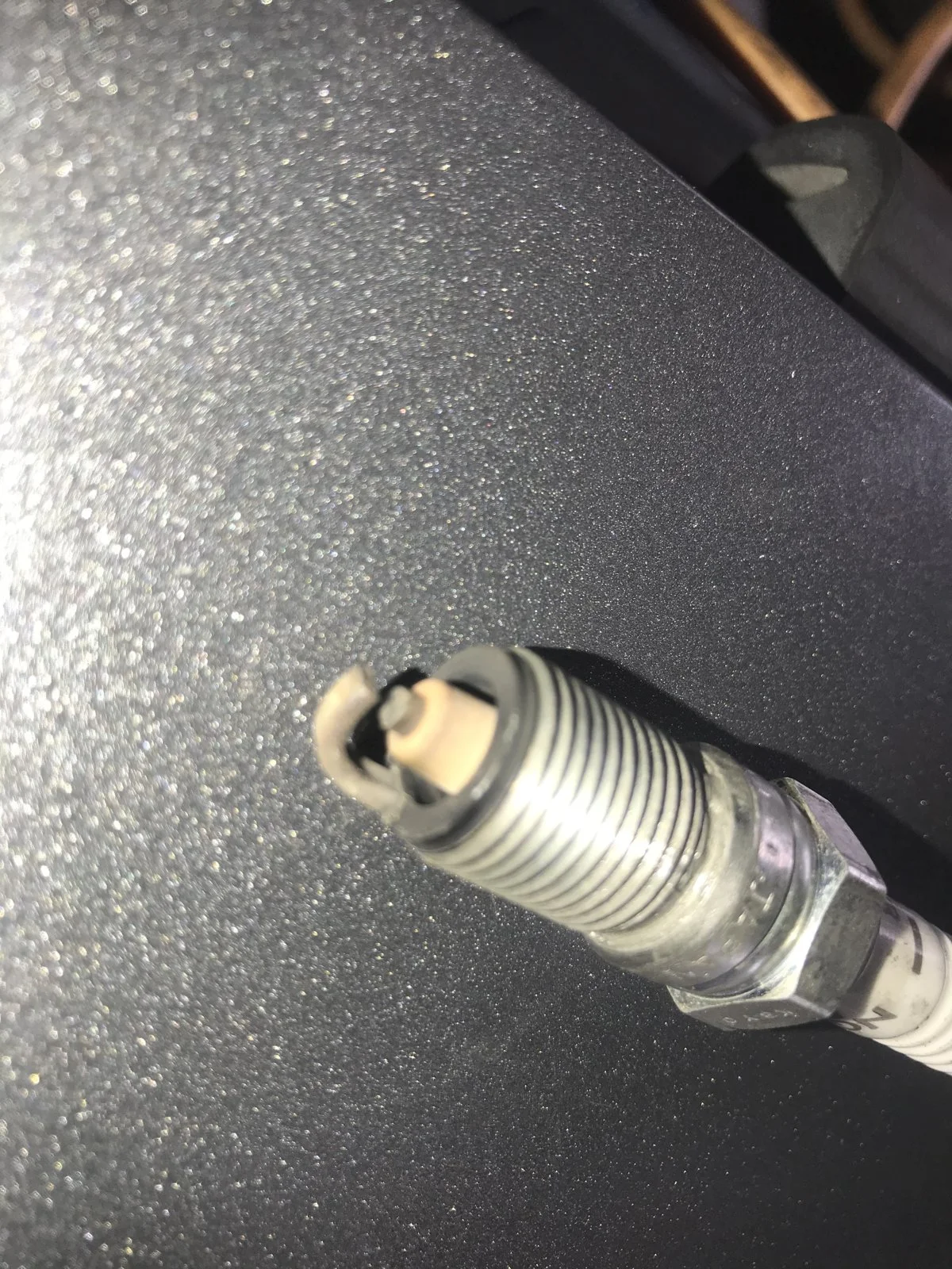

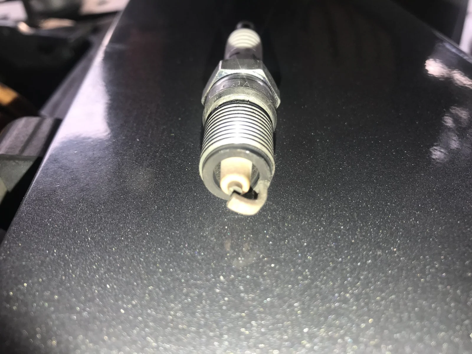

unrelated questions that maybe you can answer. All my spark plugs are white on the tip, i have reason to believe they are to hot and leaning out my motor. they are ngks and the only reason i am running them is because they had the threads that fit my heads. i have a brand new aeromotive fuel regulator and crappy truck junkyard 24 pound injecotrs. i also bought a bbk 24 pound maf tune the whole unit. i just purchased some acel 24 pound injectors brand new tonight. so maybe the injector patterns were messed up ? Does anybody know of what gap and heat to use for the plugs i hear autolite and motocraft for brands not ngk so im gonna switch. the car also seems to just rev but not gonna anywhere at higher rpms. im hoping its fuel considering heads were just resurfaced, and guides were replaced along with 3 angle valve job. compression was tested and good around 150.

Can you post a picture of the spark plugs? Most guys I've seen run the Motorcraft AGSP32C or Autolite 3924 gapped @ .052 with those cylinder heads on a mild N/A build.

The plugs look fine to me. I would start by putting the correct coolant / water mixture in and get a new radiator cap so it will allow the proper pressure to build and hold. The pressurized system with proper coolant mixture should not boil over unless there is some significant other problem. Get the cooling system correct before chasing performance or tuning issues.
NGK plugs are good plugs. A hotter heat range is not able to lean out the air/fuel mixture. They may be hot enough to cause predestination (pinging). But they do not cause the amount of fuel to change.
