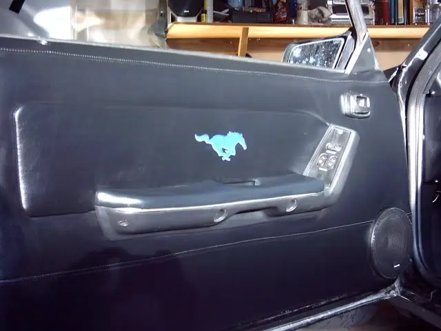

the 6.5's will require some cutting and custimazation of the door panel. My eclipse 6.5's had a 3" depth and well lets say theres about 1.5" back there at most, so i had to make some rings out of baffle board to pump it out a bit then fitted the door panel back over it.
thats what it looked like after install.
