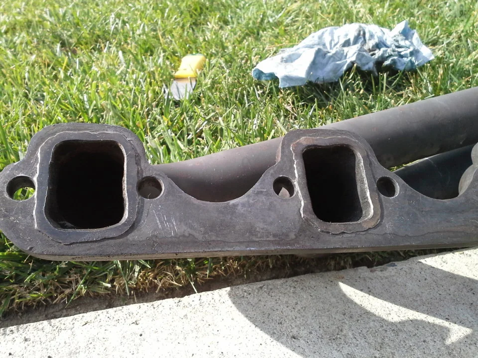

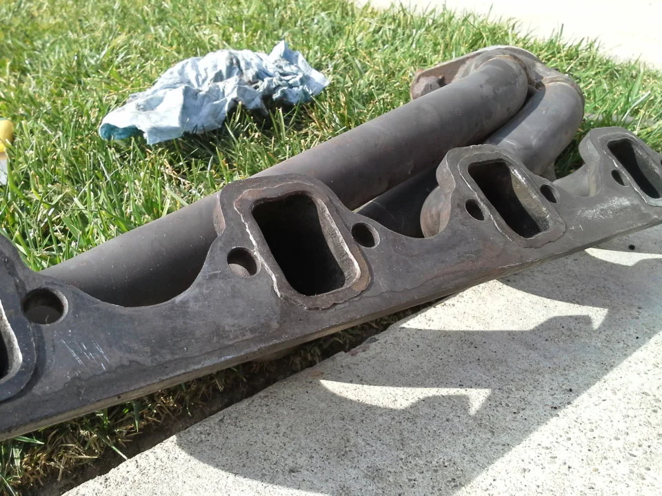

Hey guys, should I even put these back on?
They are 22+ year old JBA shorty headers (I mean, they need to go back on this is a DD not a project). Should I shop for new ones?
Do all headers have the seam at the flange/pipe? Should that get machined flat?
I am just going through the prep and cleaning them like crazy.
Unless they leak, spray them with some VHT high temp ceramic paint and slap them back on.
Cool thanks. I wish I had time for paint...plus, only getting the DS done today.
I was worried about the header flange not being glass smooth.

Smooth the raised ridges lightly with a fine, flat file then use the copper RTV on that side as stated. Unless one or more pipe flange is really receded from rust and exhsust, you should be good to go if the pipes are solid but ugly.
