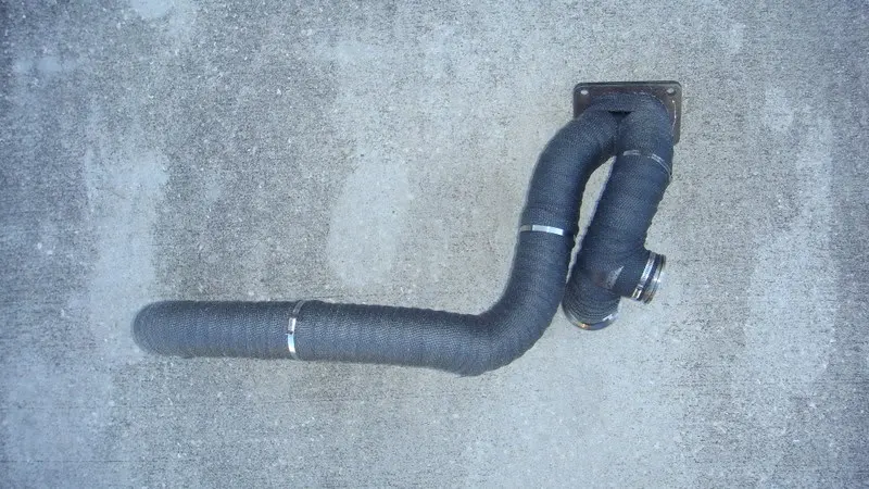

I have long tube headers. I used one 50' roll per side. I have my turbo where the back seat used to be so, I used another 2.5 50' rolls to do the 2 into 1 exhaust back to the turbo & the last 25' to do the exhaust outlet of the turbo. I got the kit from summit that comes with two 2"x50' rolls in it. You could use 2 of those & probably have more than enough. hope that helps.

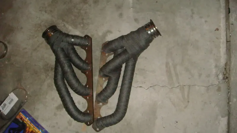

depends on what size you are going with. I would say 50' of 1" for the header primaries and 50' of 2" for the collectors, crossover and down pipe. Get the paint for them and paint them it will look 10x better than not, I used black wrap and the black paint for it. i used all one inch because I like the look of more wraps, so it also depends on what type of overlap you want
