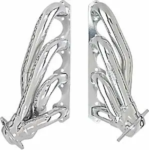

FRPP 1 5/8" Ceramic. $299. You will be hard pressed to find a nicer shorty.
