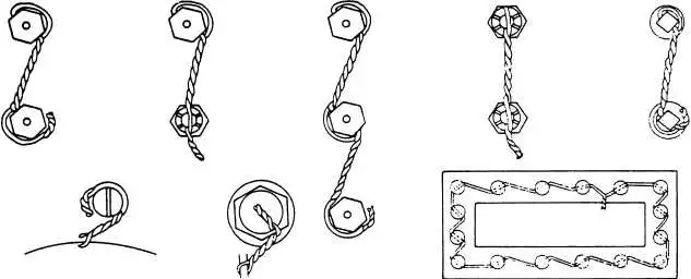

Also, If you've got problems with them backing out, Using a drill press, Drill a hole through the head of each of the bolts (sideways NOT straight down the shaft). Then run a wire through the head such that as one tries to back out, it tightens another. It won't even get 1/8 of a turn. Just tighen it up and use a nut and bolt on the end to keep it from slipping back through the bolt.
You'd string the wire fromt the bottom of the bolt up (kinda like _[BOLT]\_[BOLT]\_[BOLT]\_[BOLT]\_... etc).
It's ugly, but VERY effective.
