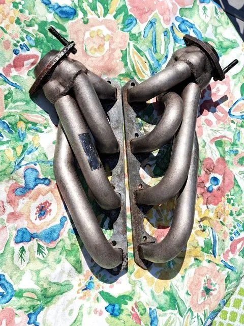

If your ditching the egr tube, The fleabay foxbody stainless shorties for $100 or less listed all over the place now work with the p plug angles... There a direct copy of the latest fox body bbk unequal lenght shorties, after they changed the tube routing to the same as P headers with the number 7 Primary tube looped out like shown on these old ford racing P set.
https://www.ebay.com/itm/2045579790...pid=5335821607&customid=&toolid=10001&mkevt=1 will need hardware for h pipe and probably better gaskets pretty sure you can find them even cheaper too.

The cheapy China stuff is stainless like the old motorsport stuff, not mild steel like bbk's. , I'd be more worried about heat cycle cracking then rot, though qualities been fine from what I' ve seen. China's been making them for pypes, lmr, Holley and other brands etc for over a decade now. Hell, headers that held up the best for me over the years on daily beater foxbody where the China cheapy Ls swap long tubes I made fit a sbf, They don't rot like the mild steel stuff, just get a little color to them.
