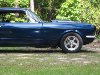

I really like my ceramic coated Hooker comps. I was running tri-ys before and thought they were ok, then when I put on the hookers I was surprised at how much better it ran. I'll never run tri-y's again. Hooker quality is good, they look and sound great. They hang a little low, but not too bad, my car sits kinda low and I don't have any problems unless I carelessly go flying over a big speedbump. I'll post a pic when I get home to give you an idea of how they sit in relation to the frame rails.

all long tubes are gonna hang low..there just isnt a ton of space and you have to clear the trans crossmemeber, the collector is big, so the outlet has to be low.

Notice how every time you come off a speed bump its going to smash the bottom tubes flat... (ala camaro)
