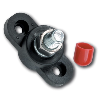

I would put it on the Sol. but the post is too full of wires.
Here is an option. I got one in good shape from a Bronco in a salvage yard.
