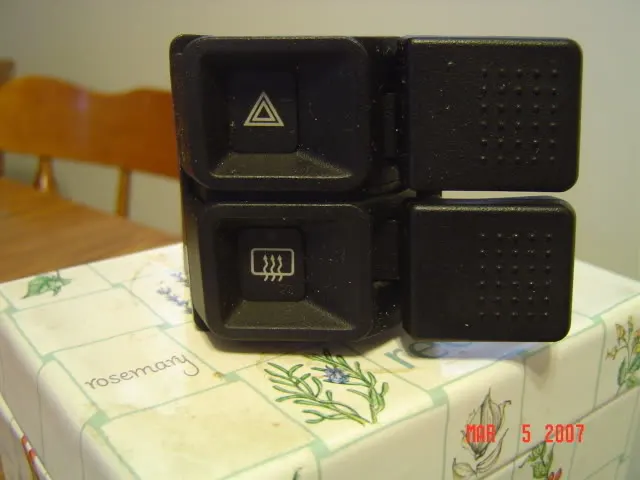

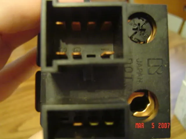

Here are some pictures of the Defroster/Hazard light switch. The bulbs are replaceable, but if memory serves me right, you have to at least have the holder to put in a bulb like from radio shack. The headlight switch lights up , but is sealed and non replaceable bulbs.

thanks guys, i had no idea thats what that round thing was on the hazard side. also, i removed the cover from my headlight/fog switch and i think i'm going to try and take the switch apart and re solder an bulb on there. if not autozone here i come.

There was a thread on the bulb on here. I do know that you can't buy the bulb and base together. Just the bulb and put it in the base. So if you don't have the base then you could always use any bulb and do some engineering to make it light up the switch.

I used a red l.e.d from Radio Shack on my hazzard switch, and put it on the factory base it works like a champ. You have to make sure its an automotive 12v l.e.d not the low volt ones so it wont explode.

The bulbs are #2182. I think the micro lamps that Radio Shack carries are too small, but they could work. You might try a hobby store. I think model trains use them.
