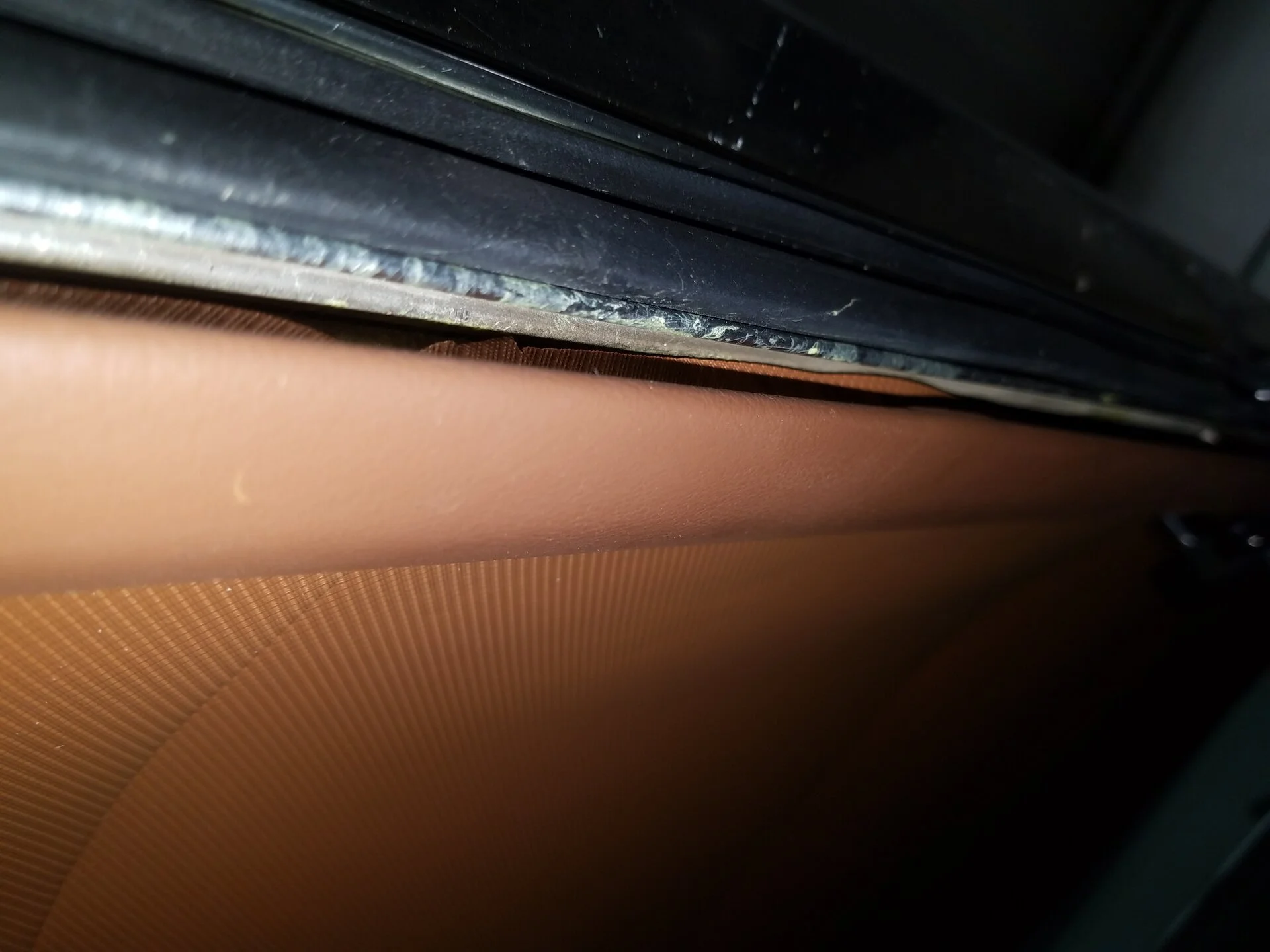

M Mustang Don Member Aug 19, 2019 35 2 8 Weston, Wi Aug 5, 2020 #1 Aug 5, 2020 #1 Is there supposed to be a gap between the headliner side retainer and the door gasket? Please see Photos. Attachments 20200805_002900.webp 102.3 KB · Views: 135
horse sence 15 Year Member Nov 29, 1999 12,297 8,154 233 Wile Coyote's stunt double Aug 5, 2020 #2 Aug 5, 2020 #2 Yes ,it is supposed to be painted body color . Trim the headliner just enough for the wind lace to cover it on the lip Reactions: 2Blue2
