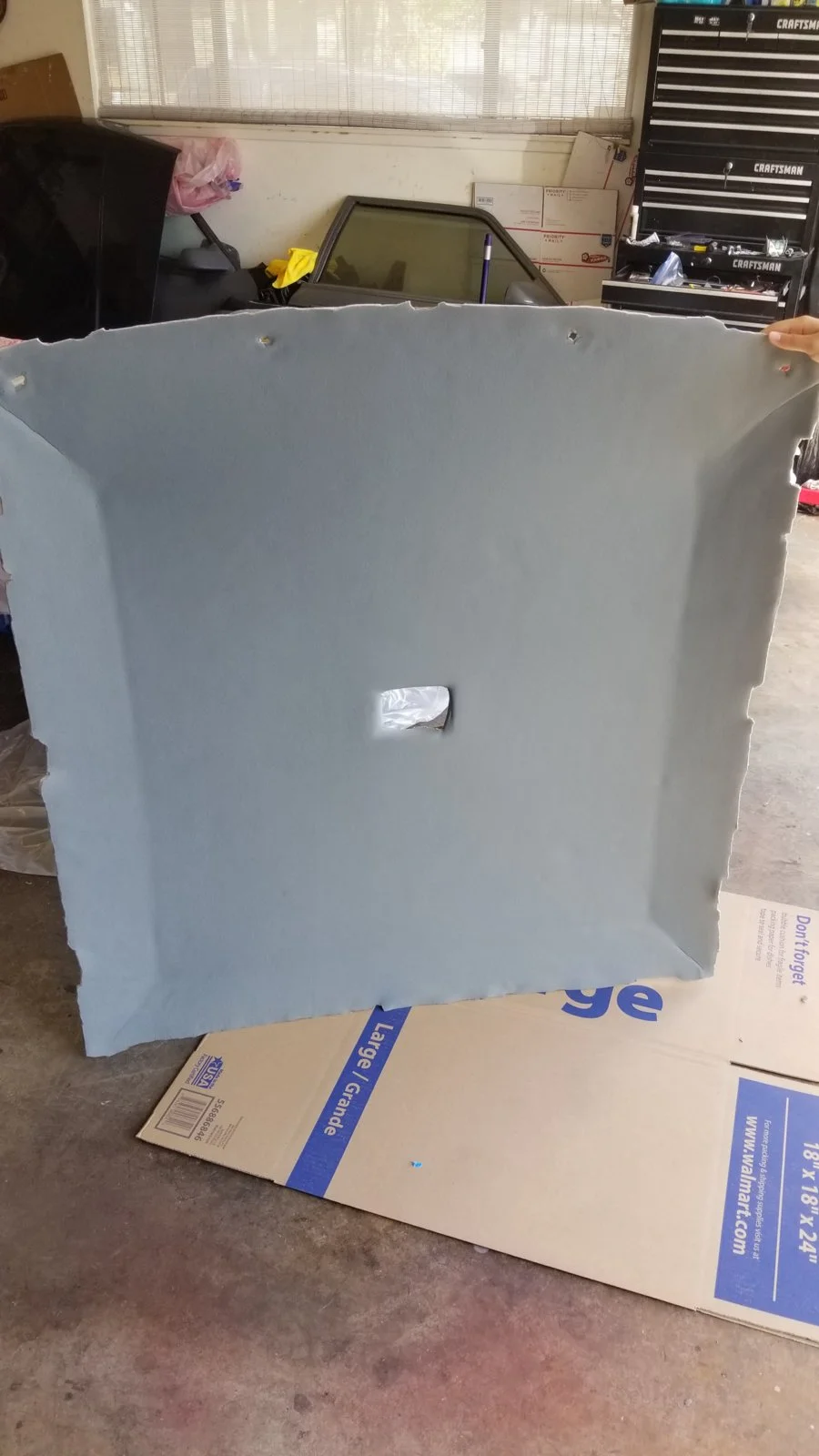

I have the headliner out of the car and the board and foam are in great shape. Like others, I found some great material locally that would look great in the car. I'd like to just spray the foam and attach the fabric hopefully with no problems like bleed through. Has anyone done this? 3M looks to be the adhesive of choice. Seems like the best option over a replacement that runs about 250 and up. Yikes.
I’ve done it a few times very simple just follow the directions on the can. Comes out real nice. If you’re using the foam backed head liner material like Joanne fabric sells it won’t bleed through..... sorry I read the post fast, I’ve never done it that way you want to. Sorry

I've done it the Joanna fabric way.
Just need to find a heavy, backed material that won't bleed through when you spray the adhesive.
Other than that, pretty easy. Have a sharp knife and scissors on hand
