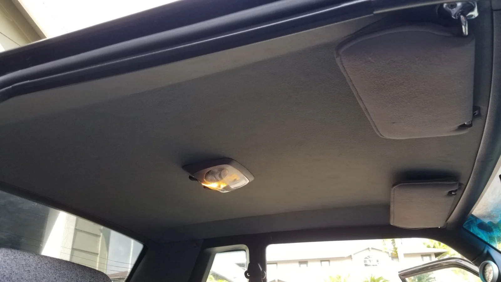

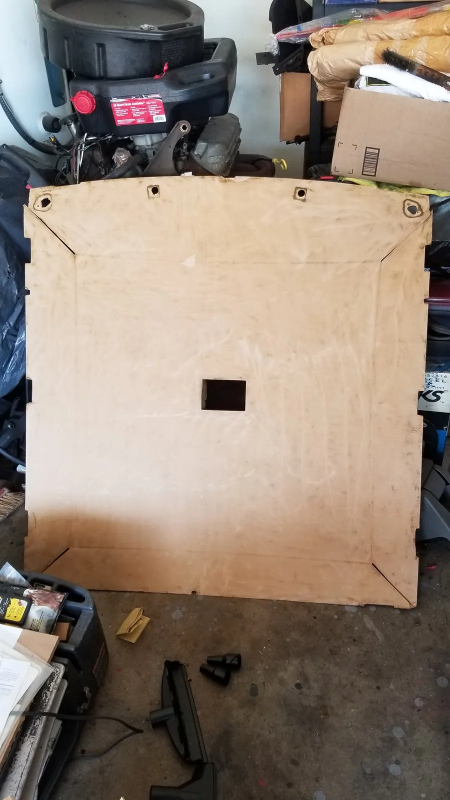

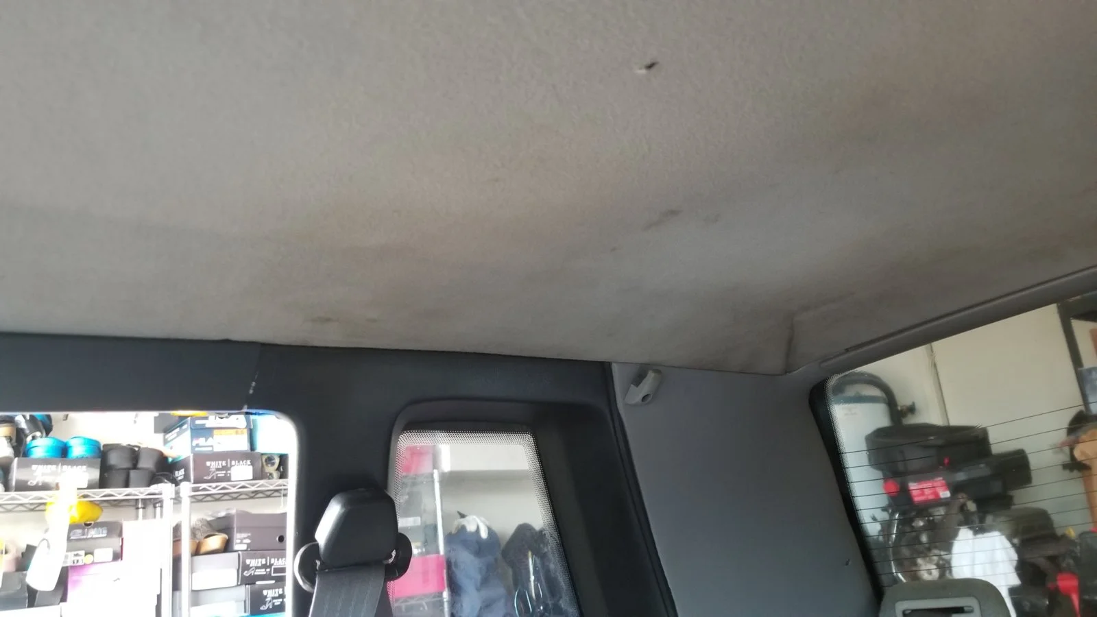

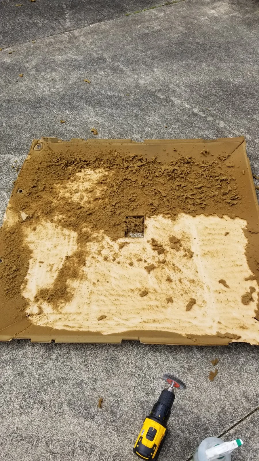

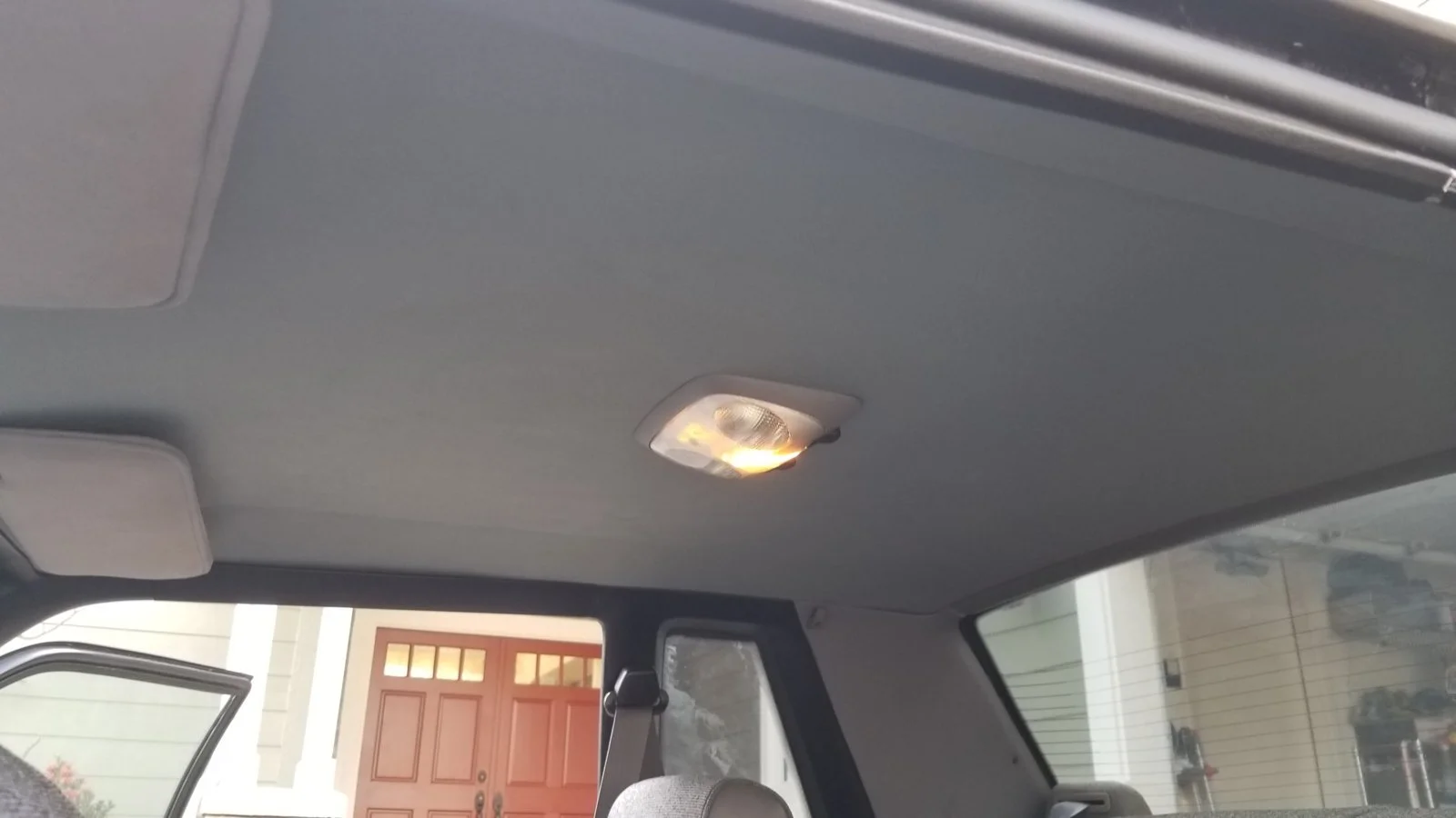

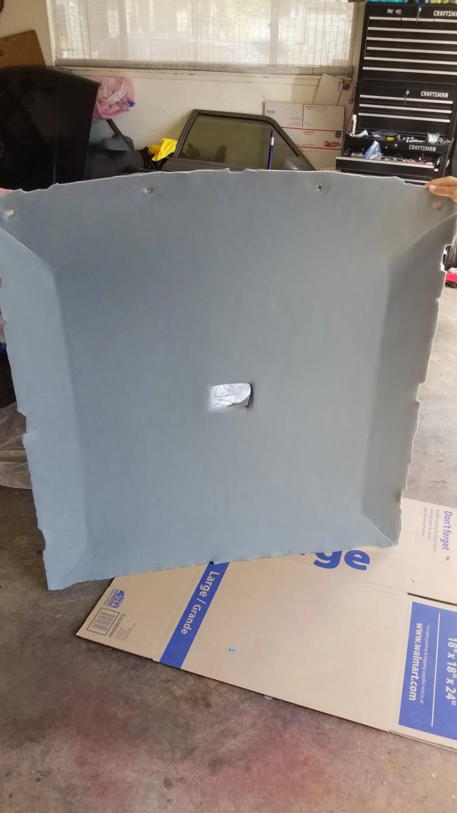

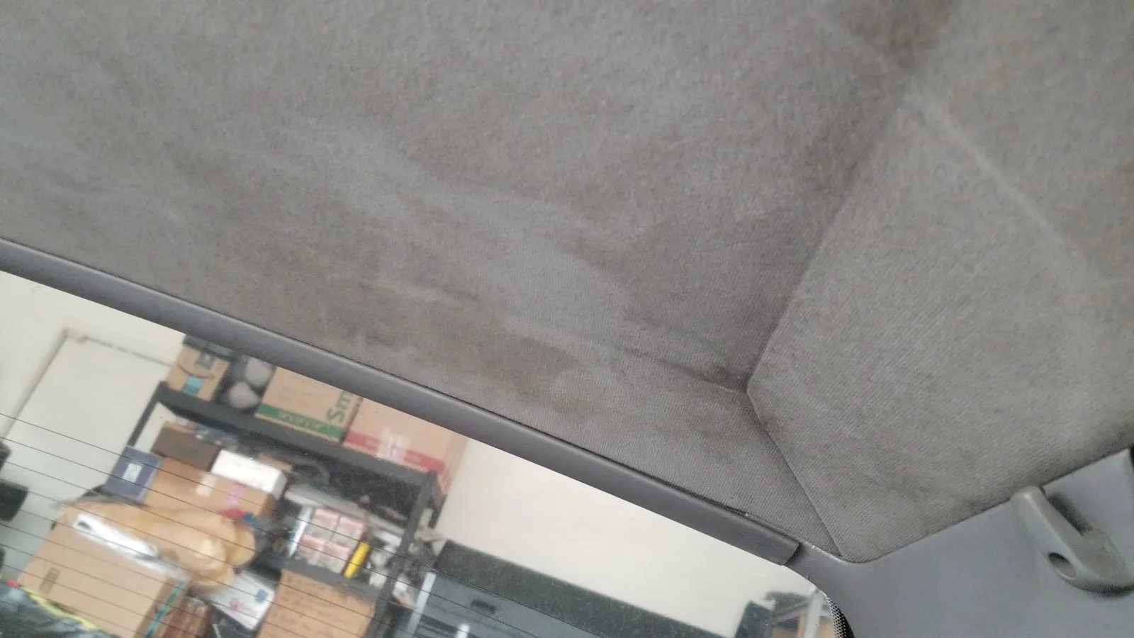

Just finished mine.
Before:
During:
And done:
I took out all that nasty insulation and put fresh dynamat on the roof. It's hard to believe but my interior smells great now. I guess that old insulation had some serious odors in it. I have a total of $65 in this project.

Usually the biggest issue with the boards is the foam "stuff" they put on it. I scraped mine all off and then applied my adhesive.

Dang that looks great. You said you removed all the brown factory foam. Did the material you bought have a thickness to it or did you lay some new thin foam down first? I'm assuming the dynamat was placed on the sheetmetal roof first? I also like the newer dome light.
Does the $65 include the dynamat? You've made up my mind, I'll DIY with some material from a fabric store (Joannes) so long as my headliner board is in good shape which I believe it is.
The $65 is total for the headliner fabric, the spray adhesive and the new wire wheel I bought for my drill. I had leftover dynamat that I used. I'm sure you can find the material cheaper where you are. I am "blessed" to be in Hawaii where the people making $135K are considered low income and a gallon of milk is $8.50.....
