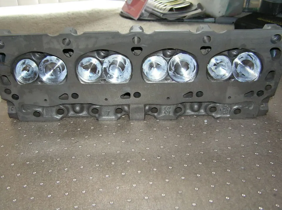

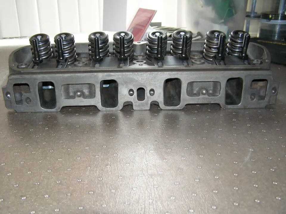

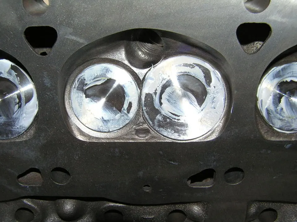

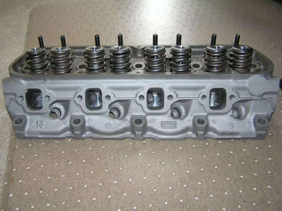

Here's a few pics of mine after getting them back from the machine shop. The white stuff is grease they put on there to lube the valves on the first start up.

I know this is going to stir the pot, but I have to say it- The more I learn about cylinder heads and engine design, the less I believe the hype about flow "velocity".
Look at the heads that GM uses on it's LS engines... Notice how big the ports are... Do you think they're worried about "velocity"?
Look at the Coyote. It has huge ports in its heads, but does it struggle to make torque? Would anyone consider the Coyote a dog, even at low RPM? Does the TiVVT by itself really make up for the big ports and "low velocity"?
Sure, the GT40P has a smaller exhaust valve, but does the exhaust port itself really have a smaller cross section? How does the exhaust flow compare to a standard GT40P?
I'm not a pro engine builder, nor do I claim to even be close to that level of knowledge. But I can tell you that when I venture into my planned engine build this winter, I'm not going to be too concerned with "velocity" when I'm buying my cylinder heads.
Just food for thought, fellas, keep up the good conversation.
Oh, BTW, 85_SS_302_Coupe, those ports do look good!
