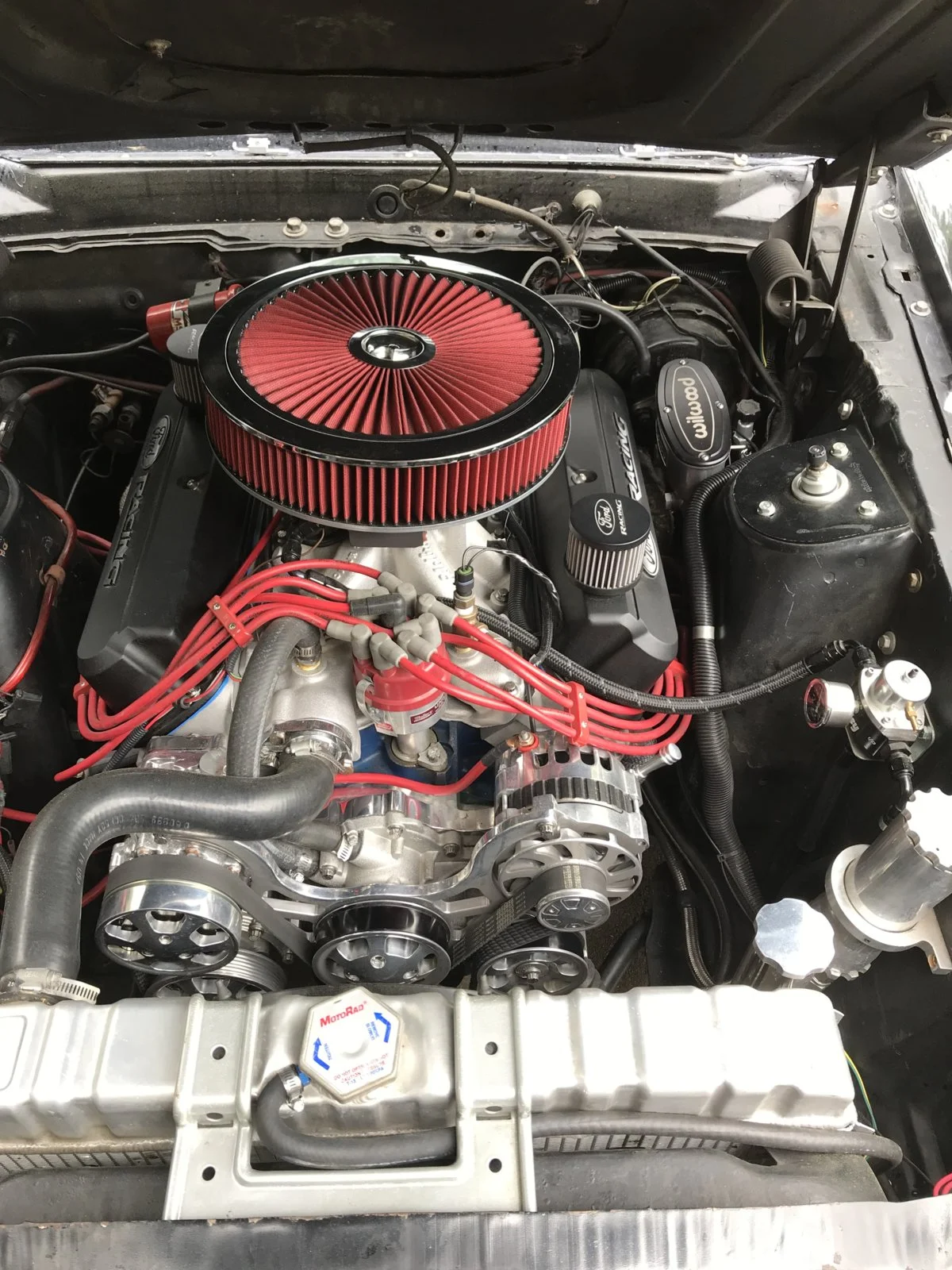

Hello everyone,
I currently have a 1969 Mach I that I have slowly been converting to a restomod. I recently had the engine rebuilt (351w) due to an oil pump seizing. The pre
vious build was rebuilt in texas about 5 years before I purchased it and ran well. I figured if I was going to rebuild it go for more displacement and made it a 408 stroker. With that, I was looking to reuse what parts were still good so I could get it back on the road and enjoy it. I currently have about 10 year old 195cc Dart heads on it and am looking to upgrade to heads that better match my build but I dont want to just throw bigger ones on and assume I'm matching parts correctly. I know this is a hot topic as I've read so many other threads on the subject. Figured I could lay out my exact build and see what you guys think so heres what I have currently:
351w block bored .40
eagle rotating assembly (EGL14123040) Stroke- 4.000 Pistons -26cc Inv. Dome
Comp cam shaft with hyd roller lifter: Dur 282/289
lift .513/.529
Intake 230 Exhaust 236
lobe sep 110
Vic Jr. Intake manifold
Edelbroc Terminator EFI
The car is a weekend driver, street only. I have no aspirations to race it although I love to get on it when I have a deserted road. I had it dyno'd but the readings were off on the dyno but I was told it was making around 400-450 hp/tq crank. I have seen other similar builds making over the 500hp mark. I would just hate to have the heads holding the power back. I have been looking at AFR 205 heads at around $1900/per. I just keep thinking the 195 heads are restricting the power. Let me know if I have missed anything in the info required. Thanks for all your inputs.

Thanks for the thorough answer! That helps a lot. For more background on the build I have had a local shop do the engine build for me. I havent been real happy with their work. The shop deals with a lot of newer mustangs and work more bolt-ons while running a dyno. I went to them for suggestions and they initially suggested the 205 heads and when I asked them more about why they suggested those heads they didn't have a good answer other than they would move more air. I wont be going back to that shop but want to make sure the next place I find has reasoning behind what suggestions they provide.
I dont have answers to all your questions but here's what I do know:
5 speed manual- tremec TKO
Detroit locker 9" 3:55
Block is 351 from '72 (basically stock but from another mustang)
ARP bolts throughout
Internally balanced
all I have is the rods part number and cost: part #300-780-8 ($118) hope that helps
not sure about the pin pistons
Idle is set at 900rpm
I was having hood clearance issues with a taller intake manifold so had to go with the vic jr single plane manifold. The air filter I have now just slightly touches the hood when I close it and I had to remove 2 bolts from the hood scoop to make it fit. I previously had a dual plane but the EFI wasn't running right and the idle would jump all over the place. The single plane has since fixed that issue.
headers are long tube hooker super comps (recommended to fit with my rack&pinion setup)
exhaust is magnaflow 3 1/2" x-pipe
other mods include wilwoods all around
ridetec level 2 coilover suspension with front sway bar
rack & pinion steering
Again, thanks for all your help and information
