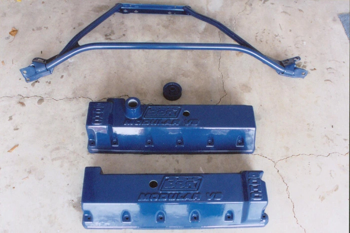

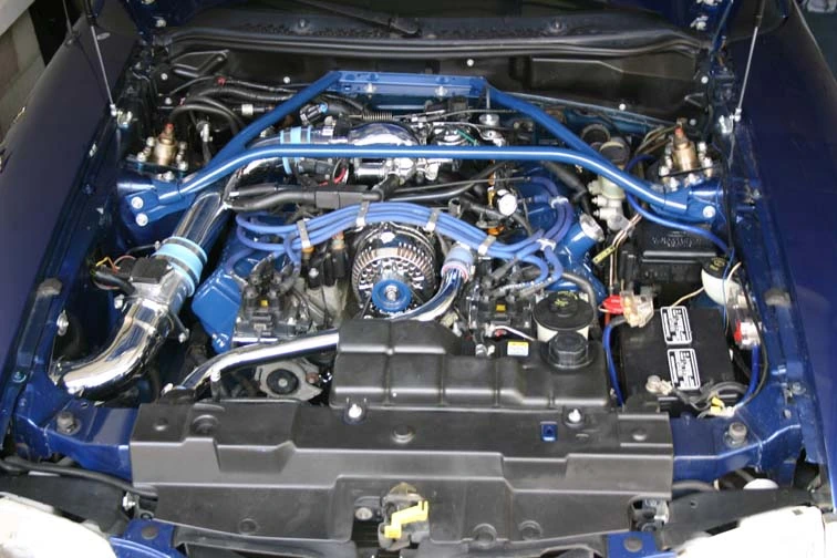

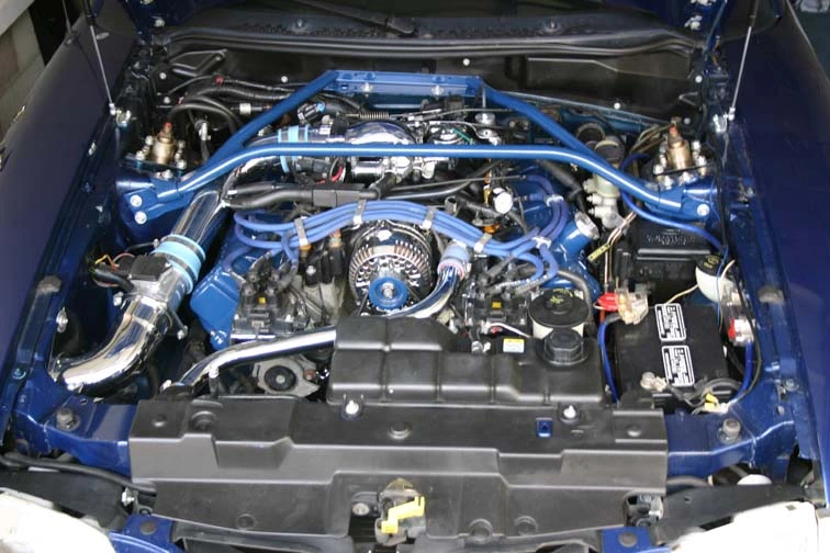

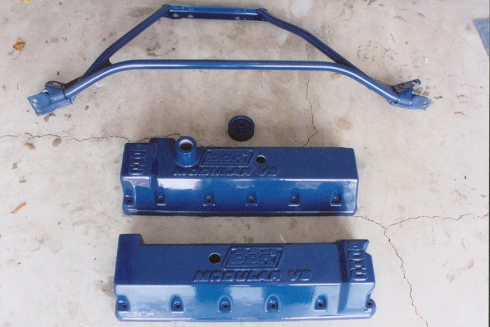

you cannot powder coat or chrome the factory ones, since they are PLASTIC....I took mine to a place and they laughed..said they would melt during the process. I bought a set of BBK ones, they come in chrome or powder coated silver. I wanted mine blue, so I took them to a place, and they told me they had to remove the old powder coating, before they could put on the new stuff. Total cost was around $200 to remove and powder coat the new ones. I am glad I did it, looks a ton better!
