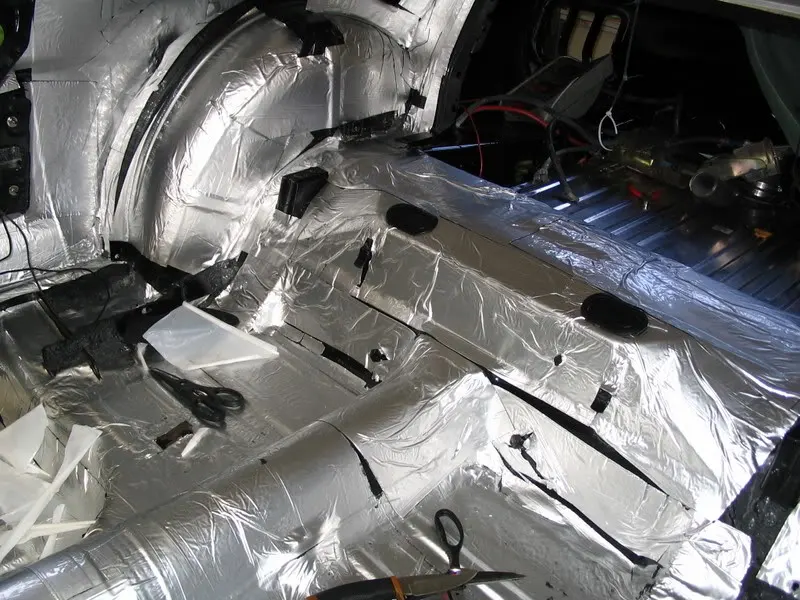

I just finished putting 160 sq ft of dynamat type deadener in the 67;floors ,roof,door panels,inner wheel housings and trunk as well as firewall,next will come 1/4 inch closed cell neoprene foam. I will add more to the tunnel and below the rear seat above the diff and mufflers. I am trying to quiet it as much as possible and weight is not so much a concern in this restomod. The lizard skin should probably be quicker than Dynamat to install.

entdoc- I have Dynamat in my garage ready to go, but I have a question... What order do I go in? Do I put dynamat in before everything?
When dealing with bolt holes for seats/seatbelts/etc, do I make a cutout for the bolt hole only or for the entire contact point? (I hope that makes sense...)
dynamat in first.remember this layer is for deadening the resonance of the metal panels and provide some sound and heat insulation. I just put the stuff in and cut around the bolt holes. no larger than the hole itself.

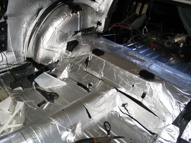

Isn't Dynamat only sound deadning material, what are you doing for heat insulation?
