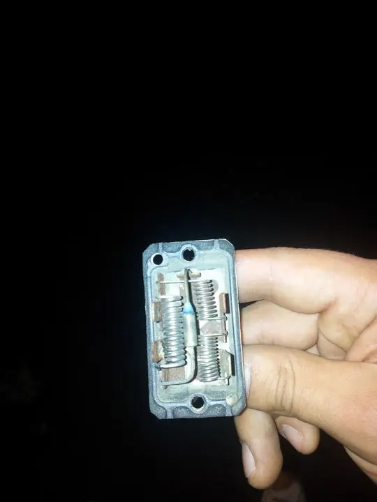

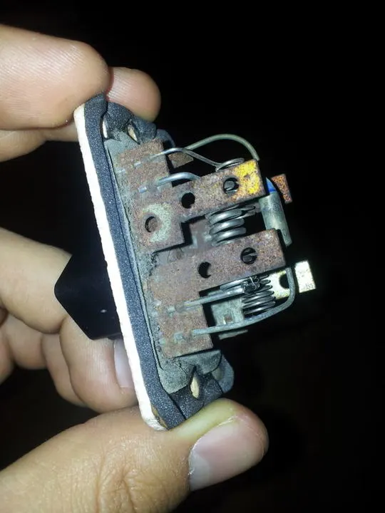

Today when I was cruising around I noticed that my vents would not blow air no matter what setting I had it on. Now I was under the impression that if it only blew air on the high setting, that meant a bad resistor. But if it didnt blow any air at all, that meant a bad motor. So, I decided to pull the motor and resistor to see what was going on. I hooked the motor up to my battery and it seemed to work just fine. Im confused. Should I just replace the resistor or does this mean my problem is somewhere else? Here is a picture of my resistor:
The rust does concern me but not sure if that would be the cause blower motor failure since the motor is not blowing any air at all.

See if you get any power at the resistor. If so I'd put money on that being the problem. And as always, triple check the fuses!

Not sure on that. How much is a new one? Might be easier to get a new one and test it to see if it fixes the problem.

Yeah it is only like a $20-$30 part at oreillys. Ill just replace it anyways.

The fan motor is definitely good. It's either the resistor or the fan switch. Do you have a multimeter or a test light? You should check to make sure it's not the switch. Use a test light or multimeter and test the plug that goes to the resistor. When you put the switch at a different speed, each speed should send power to a different lead on that plug.
