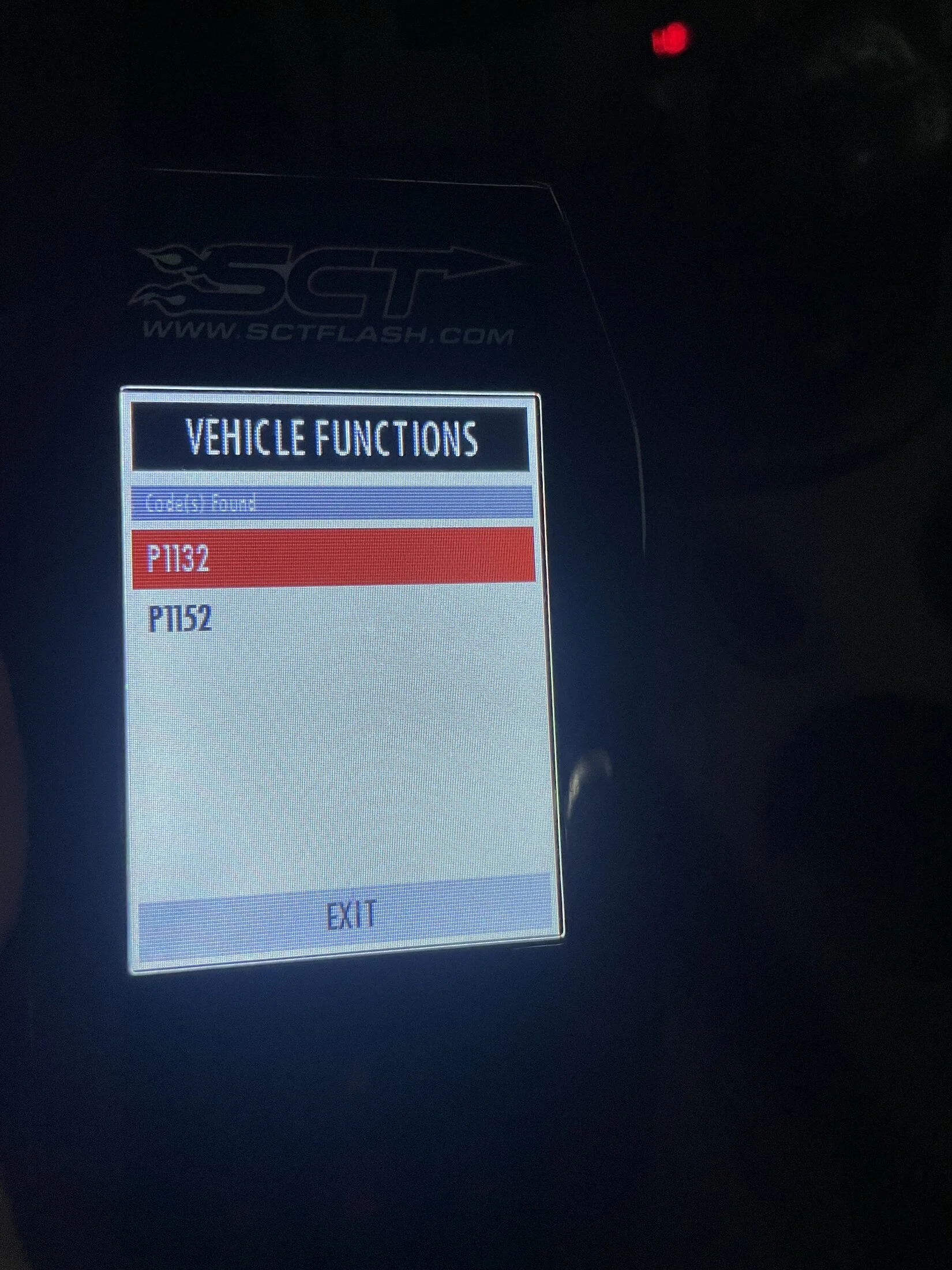

P1132 and p1152

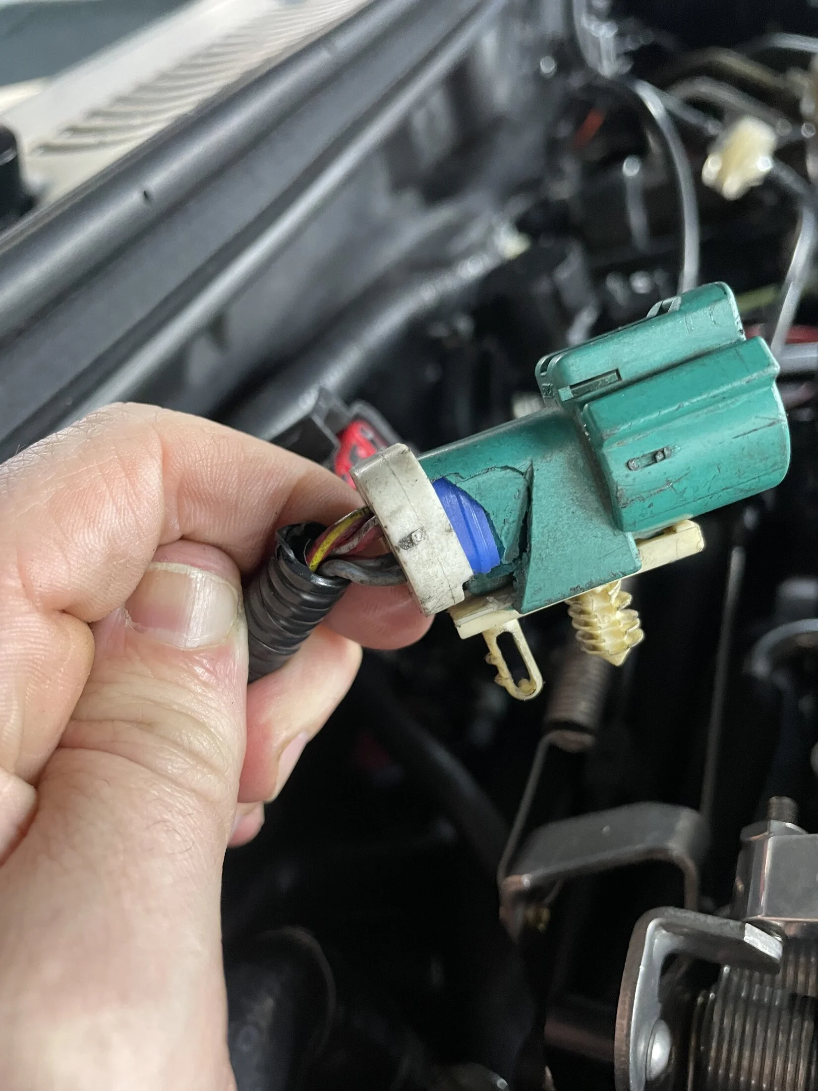

Replaced a broken 02 sensor connector bank 1

How do you test for a leaking injector? All I got left is to replaced the coils and plugs but I doubt that’s the issue. Car runs fine but the CEL will come on 10-40 miles after I clear it.

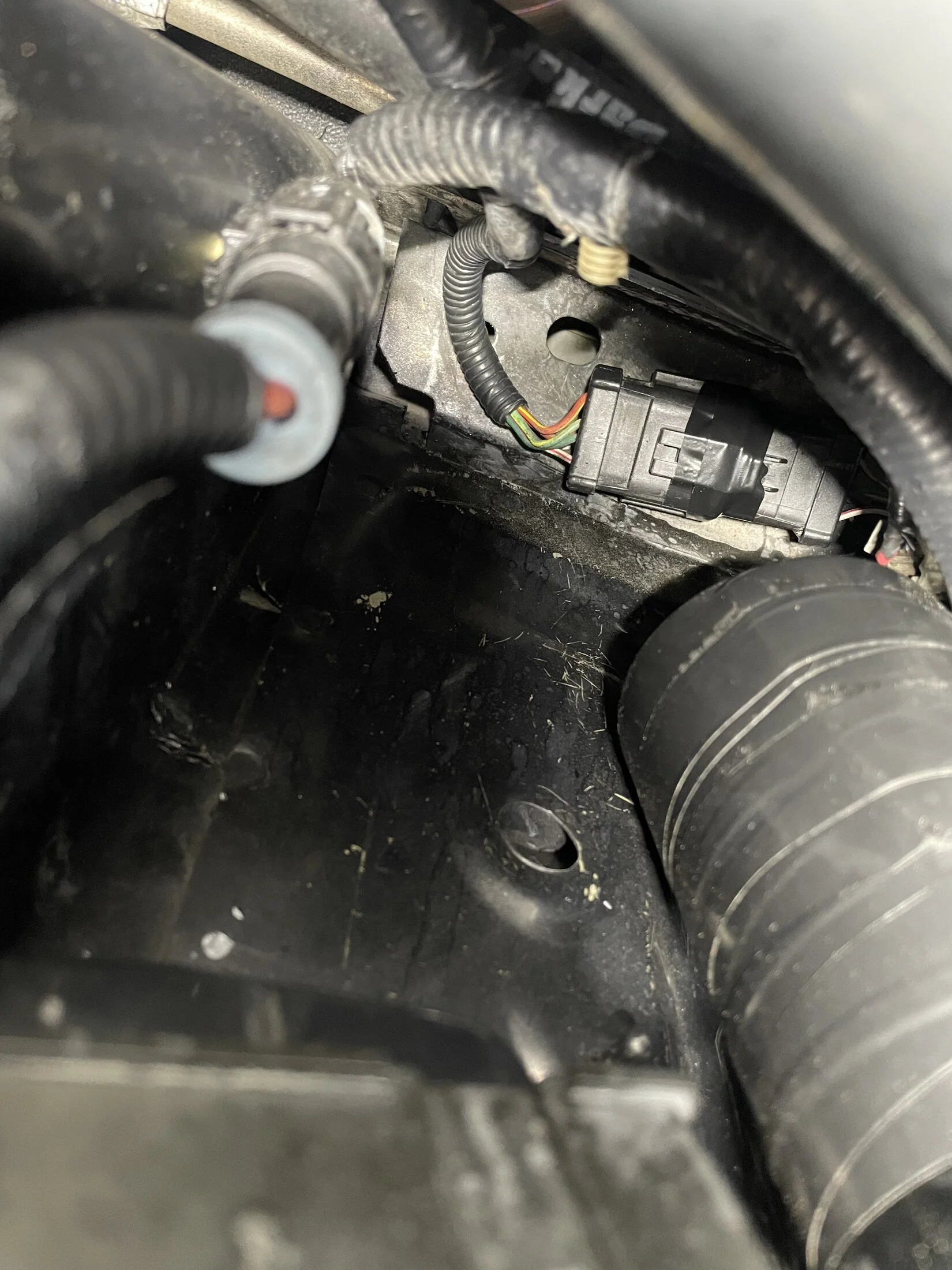

I did find a loose connector under the induction tube(black connector)when I pulled on it separated. I cleaned the connections and tape it together along with many of the other connectors on the 02 sensor harness to make sure they don’t loosen up.

Installed new Motorcraft 02 sensors and the my AFR still shows lean on the drivers side. Doesn't seem like the new 02s fixed anything. I went ahead and ordered a new MAF because Ive ruled out everything else at this point. Ive checked the wiring and connections 100x. I went as far as removing the rear harness and removing some the loom to inspect the wiring. Ill go over it again this weekend to see if there is anything that would cause this.

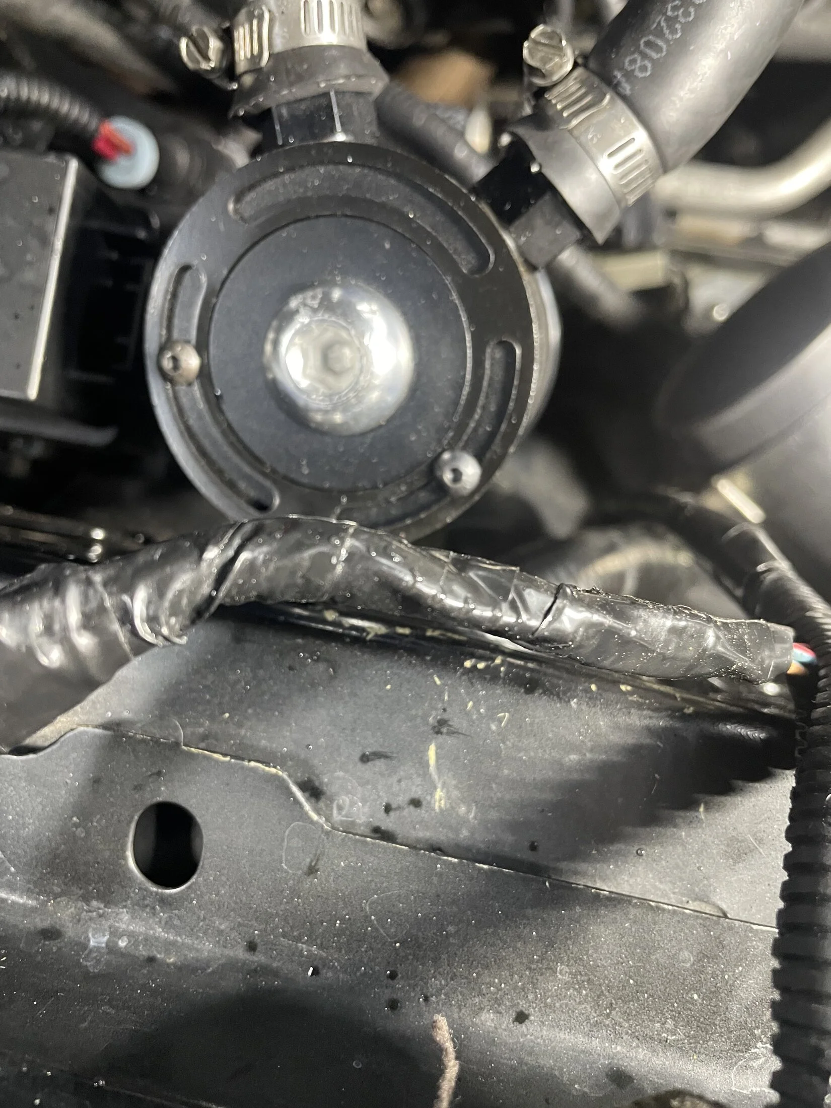

I did find moisture on the mass air wires when I took apart the loom and tape. I’m not sure is this is the cause. It was definitely wet. I dried it out and taped it all back up. I wet over the connections again and took the wires out of the factory loom but didn’t find any moisture.

Some sickly residue from the electrical tape. I did get into the blue wire a bit with the razor blade but it didn’t expose the wire. I hope that was it as well because if this new mass air doesn’t fix my issues I’m buying a replacement engine and transmission wiring harness.
Changed the mass air and reset the KAM. Car is relearning everything so time will tell. My AFRs while cruising are back to normal but my chop chop of my cams is gone. I’ve been told they will come back after the computer relearns.
The chop never came back after 20 miles with the new mass air so I swapped my original mass air back in and didn’t unplug the battery. Cars cammed idle came back and the AFRs while cruising are back to normal. Maybe the water on the wires to the mass air was the problem? Maybe the cheap O2 sensors or resetting the KAM? Idk anymore. For now it’s running like it should but I’ll update this thread later when I put some more miles on it. Next week I may fix the exhaust leak by installing new gaskets.
