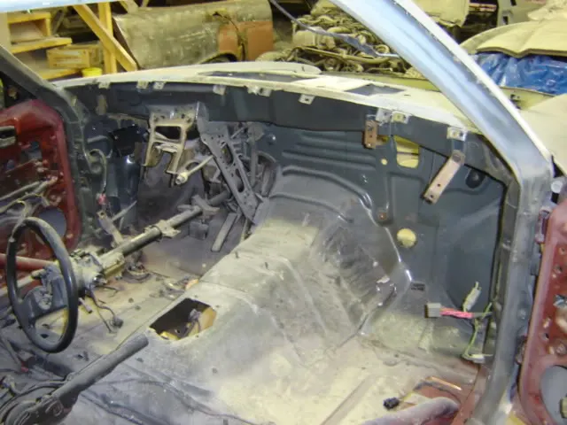

It only took me 15 minutes... lol J/K

I dunno, still looks really time-consuming, but I haven't seen the method of keeping the heather box propped open to do it before, so that's cool. I still need to buy and install a new heater pipe before I go worrying about dropping in a new heater core, myself, though...
