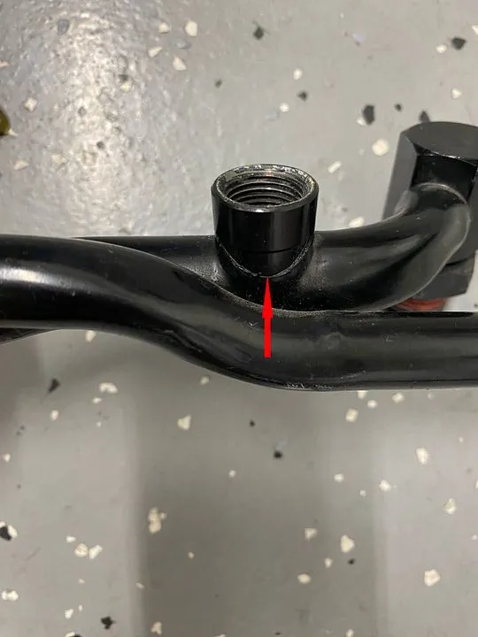

Found the problem. Evidently the bung is braze welded into the tube and the weld is no bueno. Its leaking were the red arrow is pointing in this picture:
Went to OReilly's and got the loaner tool to pressurize the cooling system and it only took one pump on the air pump for this to leak so it has to be a seriously bad weld.
I am taking the old tube and this new one to my buddy Tuesday night and he is going to tig weld the bung to the tube on the new leaking one and remove the EGR nipple and weld the bung to the tube on the old one. He literally just welded up the EGR nipple on the new one which is why I swapped them out. Very sad quality control from whomever made this piece for Ford.
Anyhow, another week down the tubes on driving the car but at least I know it will be fixed right.
