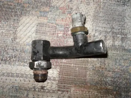

do you still have the heater core metal tubes? if so, what I did with mine is just cut the tube & turn it around toward the front & connected the water pump tube to it. I didnt want to chance capping off lines. Just an idea that worked for me.

Here is the pic of how I cut my metal tube that went from the manifold to the heater core with the coolant temp sensor.
