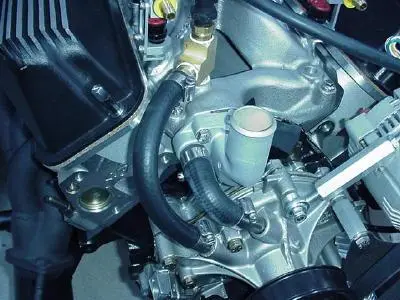

Dino Dino Bambino 15 Year Member Jun 13, 2007 1,672 89 79 Cyprus Mar 12, 2009 #5 Mar 12, 2009 #5 If you decide to remove the heater hard lines altogether and bypass the heater core, you can do as i did and install this neat little kit: Breeze Automotive Factory Five Racing
88-378 Member Aug 10, 2007 14 2 16 Alpharetta, GA Mar 12, 2009 #6 Mar 12, 2009 #6 Bullitt95 said: If you decide to remove the heater hard lines altogether and bypass the heater core, you can do as i did and install this neat little kit: Breeze Automotive Factory Five Racing Click to expand... That looks nice, but i don't want to bypass the heater core. so, i guess i will run them straight to it.
